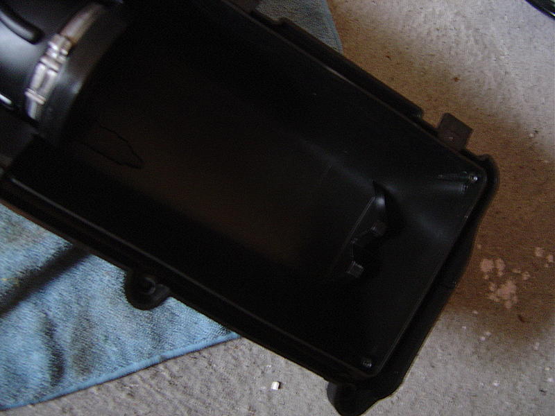

Old Oct 9, 2007 | 02:02 PM
japper's Avatar
japper
Joined: Jun 2007
Posts: 154
Originally Posted by maximusGeek
Are you talking about the plastic part that fits into the triangle fitting in the cap of the filter? Then yes. And yes, mine is a US kit. The R56 filter hangs upside down, I'm worried that a foam filter might come loose with out the clamp.
No, under the filter ( or rather on top of ) after you have removed the filter completely is a 'V' shaped protrusion moulded into the airbox lid.
Do you have this feature on US spec cars ?.
The ITG filter apparently uses the triangular retaining lug as the OEM paper one.
Old Oct 9, 2007 | 02:05 PM
japper's Avatar
japper
Joined: Jun 2007
Posts: 154
Like this photo taken of mine.

Old Oct 14, 2007 | 04:43 PM
maximusGeek's Avatar
maximusGeek
Joined: Aug 2007
Posts: 204
From: South Bay, California
Japper,
I took mine apart again and yes, I have the same "V" on my air box. Looks like it part of the hold down for the filter.
Your right about the the other measurements, I took some more while I had the box open
I looked for the Green filter but could not find the part number. I see they make a Cold air intake for the R56. Do you have a link or different part number?

11. Reinstall the filter holding plate with two screws, Secure the lateral brace with one screw.
12. Reattach the airbox top to the base in the MINI. This is not as easy as it seems, at least on my three forays into the airbox. Looking at the filter side of the top unit, you'll see that there is a single tab at the working end of the airbox. The tab is situated in a crowded narrow area that has to articulate with the base. If you just try to plug in the backside tabs, the airbox is misaligned because of the working end tab relationship. To install, you have to find the right angle to be able to capture all 4 back tabs and the side tab. Try to come in with the top unit parallel to the bottom unit while it is still 1/2" away from mating. It's a pain but suddenly it pops into place. Just go easy.
13. Reattach the harness to the air sensor.
14. Tighten the downstream screw clamp.
15. Tighten down the 4 airbox screws. I don't have torque number but go easy on the plastic.
16. Wipe down the airbox and you're done.
Have fun!
