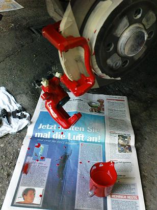

I painted my Calipers last weekend
I just finished my calipers. with dissasambly all things in one day.
And the result is much better than i dreamt..
And now its so cool chilliy forever and ever
