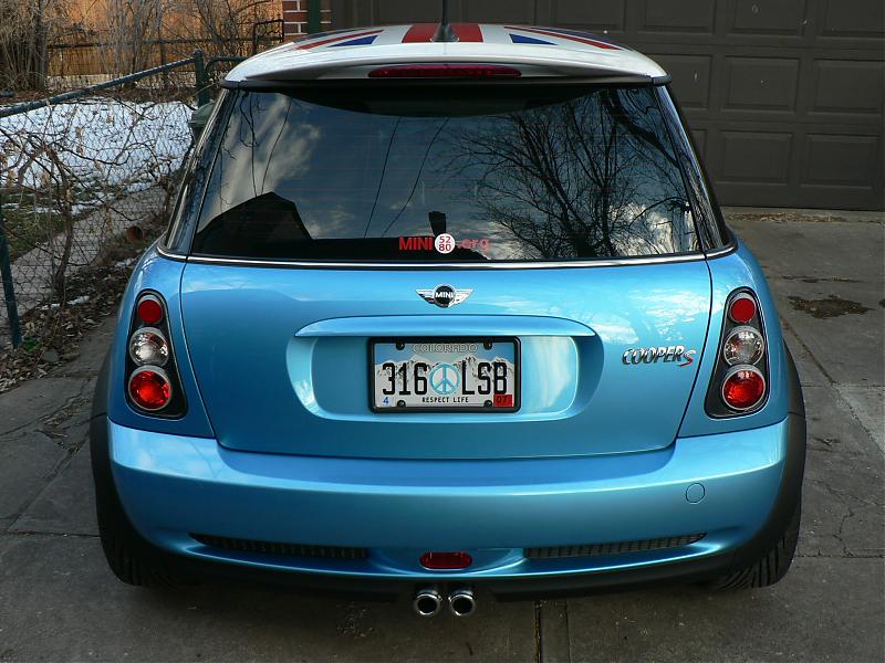

Last edited by RCGMini; Dec 11, 2006 at 03:17 PM. Reason: Sorry, I'm having problems attaching the photos. You can see a couple in my gallery.
Old Dec 11, 2006 | 03:49 PM
  #44
RCGMini's Avatar
RCGMini
Joined: Nov 2004
Posts: 13
No Rear Wiper Club
Here we go.
Attached Thumbnails Removing rear windshield wiper-p1030803.jpg   Removing rear windshield wiper-p1030805.jpg
