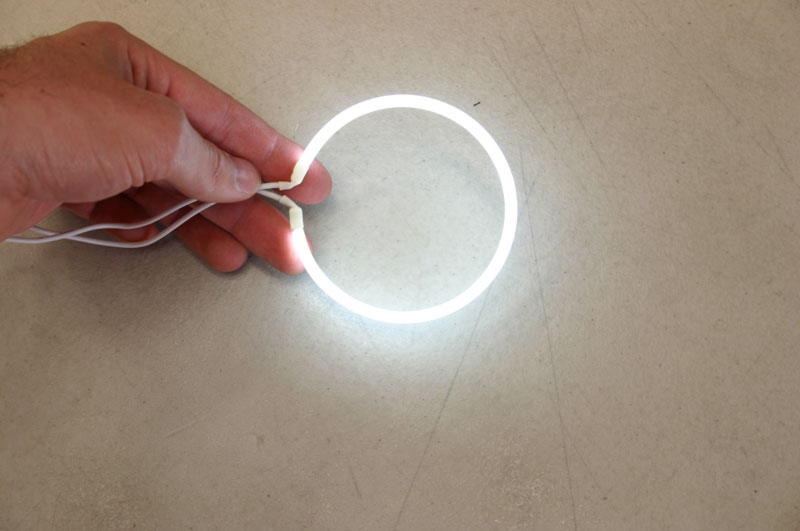

There are How-tos on the web for making acrylic diffuser rings for LEDs... You start with clear miniblind wands, bend them to size and use a Dremel to cut in the diffuser notches. Then you use LEDs fitted into the cut ends for the glow. They'd be like the Optilux if you did that - visible at night but not bright enough for day use.
Or, you can see if any of Oznium's CFL kits will work - they ARE bright enough for day use, and come in several sizes. If one is appropriate for the driving lamps you have, I bet you could fit them inside. If one is the right size be sure to let us know - at only $25 a pair, they're cost effective too, but I'd definitely use a bead of silicone to insulate them in the lamp housing. CFL tubes are glass and are extremely fragile, so a backing of silicone should insulate them against moisture and vibration all in a single stroke...
As you can see, they're quite bright:
Old Mar 13, 2009 | 09:03 AM
BlimeyCabrio's Avatar
BlimeyCabrio
Joined: Sep 2006
Posts: 8,773
Likes: 9
From: Holly Springs, NC
Those are pretty sweet... I'm looking into this now...
