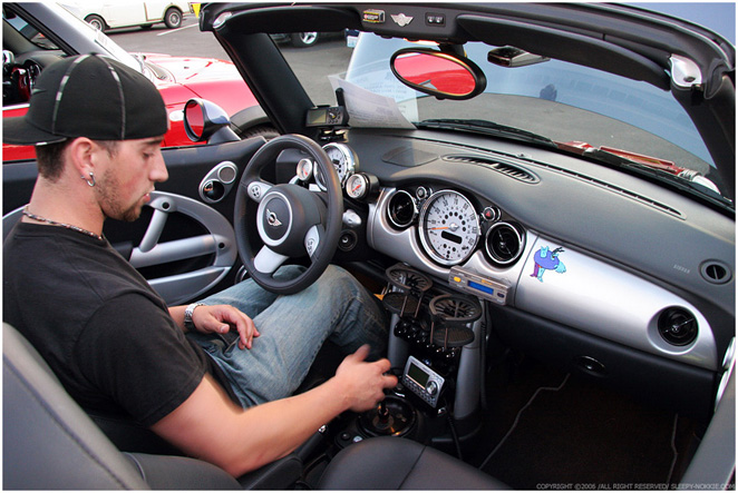

Not to much of a close up but the Well Plate would work just fine with the stock shifter.

Installing with the stock shifter woulf take all of 5 minutes if you very slow. Remove your shift know, then the stock boot, pull the ring up and turn it inside out and cut the ziptie in the inside. Boot will then come right off. Install Cravenspeed foam shim, and screw anchor(in the aft drivers side screw hole, it is ithe bigger hole) and plastic cover, then install well cover and screw down......
