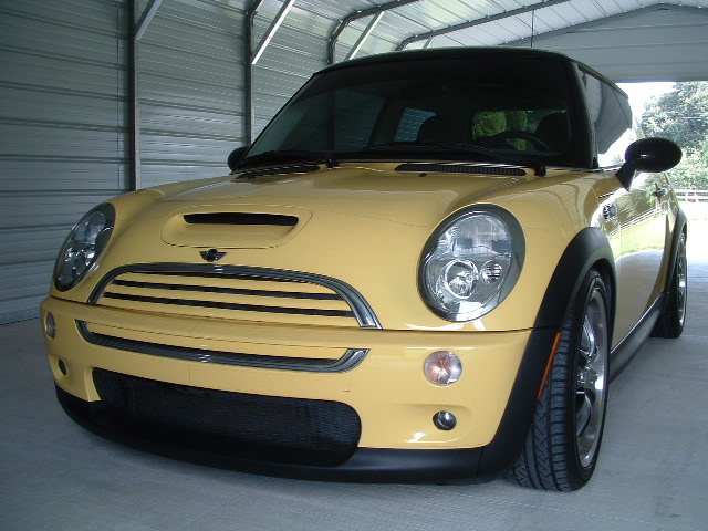

Here are a couple pics before and after the grill install.
Attached Thumbnails Aero Grill, alot tougher to install then I thought.-mini-before-face-lift.jpg   Aero Grill, alot tougher to install then I thought.-mini-after-face-lift-2.jpg

Looks good - It really works well with that color
Psst: might want to think about some real ramps though
