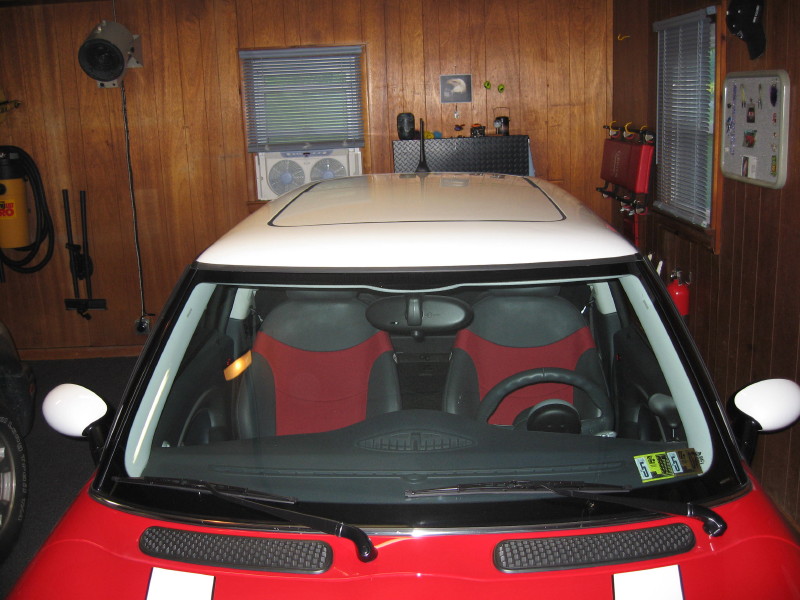

As many people have brought up the subject of heat build-up in a parked MINI on a hot sunny day, I tried something new. My 05 CR was ordered with a dealer installed American Flag roof graphic. It lasted about 14 months and started to lift in one corner. I removed it, but noticed the car seemed to get much hotter when sitting in the sun! i did not want to spend another $250 for a dealer installed graphic. And so, the hunt began for an alternate solution.... A friend has a body shop and found an epoxy primer that adheares well to glass. We primed the sunroof ,(2 mil thick coating,several coats applied) painted and cleared the sunroof, used pinstriping tape to put a black edge around it.(the felt edging around the sunroof was masked-off to give a "Factory Appearance". Roof looks great, heat build-up is greatly reduced, and one unexpected result.........from the inside of the car, the sunroof has now become a "MIRROR" ! I like it, it reflects the whole interior if you look up at it! Thought I would pass this on in case anyone else would permanently like to cure the "Hot Sunroof Problem".........

No, I haven't taken any pictures yet, just brought it home from the body shop. I will take some pictures,and post them. I have allways liked the looks of the white roof with the CR body, but also wanted the sunroof, now, it looks like I've got both, and the paint should hold up well. Can't wax for about 2 weeks, the Epoxy primer takes that long to fully cure under the paint.

Sunroof Pics...................as promised.....................
Attached Thumbnails Painted Sunroof-img_0053.jpg   Painted Sunroof-img_0057.jpg   Painted Sunroof-img_0059.jpg

very clean look. thanks for sharing

I saw a BMW the other day with the same thing done...and I thought of this thread. It looks very nice, and well done.
