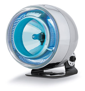

How do you guys like this look,
The PIAA P-9000 installed in the lower grille
(This is a photoshop version, just a try out)
The new P-9000 Ring lamp is a 4" (100mm) round
lamp with a long range driving beam and an L.E.D.
Halo Ring as an accent. The L.E.D. Halo Ring emits
a white glowing ring around the Super White lamp,
similar in appearance to the headlamp of the BMW
5 Series sedans.

Would they be more effective mounted higher or doesn't it matter?

yep, they are designed as driving beams so it should be mounted higher, same height as the headlights...
that said, the photoshop job looks good....

eh, not really my cup o tea, Given they are PIAA, so no doubt they are quality, something about them just looks sorta cheap to me

You opened up a can of worms asking that so since you asked
  1. See http://www.piaa.com/Lamps/Lamp-pages/p-9000.html. Thats a 15 Degree driving light ... not quite a pencil beam but you want those light as HIGH as possible. On the roof would be ideal but the grille will do Never put driving lights where fogs go ....
  2. H1 halogens with those PIAA 100W equivalent marketing hype. See http://danielsternlighting.com/tech/...uperwhite.html Note where he calls them a "sham" and in particular "The laws of physics are the laws of physics. They don't bend even for the highest-paid advertising agency. There is no way to get "85 watts of light for 55 watts of electricity." I particularly like that quote
  3. Check out the price of those bulbs ... about $100 for a pair Normal H1s are less than $20/pair. Whats with that?
  4. Of course, you can't believe everything you read so when I was looking for decent auxiliary lighting I went to my local speed shop ... full of Japanese bulbs complete in packagin without english. I asked about the PIAAs and those guys specifically said ... forget about them, you get LESS light.
  5. I don't get the M5 comparison. Whats the point of that? Who cares if you look like a BMW ... this is a MINI where youification and being unique is the norm. Trying to look like another car is ... ???
Sorry dude ... IMHO, not a good buy.

Should we believe every thing we read?
Personnally, I think they look good there, and original, not every mini will have these.
I might install a set

No, we shouldnt believe everything we read but if enough people and resources tell you that mounting driving lights where Fog lights go, I would tend to go with the people who do it for a living .... like the Rally Drivers. Ever see their light rigs? Do you see driving lights where their fog lights are??? Where would they put their FOG lights?
The PIAA bulbs at $100 a pair are ... well call em what you want. You won't see any better from them
but they might look "cool" if you want form over function.

hehehe those dont look good at all. Look very "honda" style to me.

not defending the piaas or anything, but the piaas are designed for looks, not for anything else...
i just turn them on just for looks, i dont have oem fogs so i got piaa fogs put on with some nokya bulbs, so far so good... so im not complaining

they look like laser guns.

Was talking about this tonight a DAMM meeting. I think they would look good if the could be a functional replacement for the turnsignal. Another neat hting could mounting them behind an aero grill. I think I might try doing some custom angeleyes in the 05 headlight surround myself. If you're going for the lower grill type thing then I'd say drop em just a little lower and maybe bring a bit toward center so you'll have a better idea of where they'll be if you use a PIAA maddness or OEM or Hella bracket. I likr the concept though

yah...putting them behind grilles would definitely help. But the problem is that these are rather long. You need a rather short depth to fit them behind the grill but in front of the radiator.
