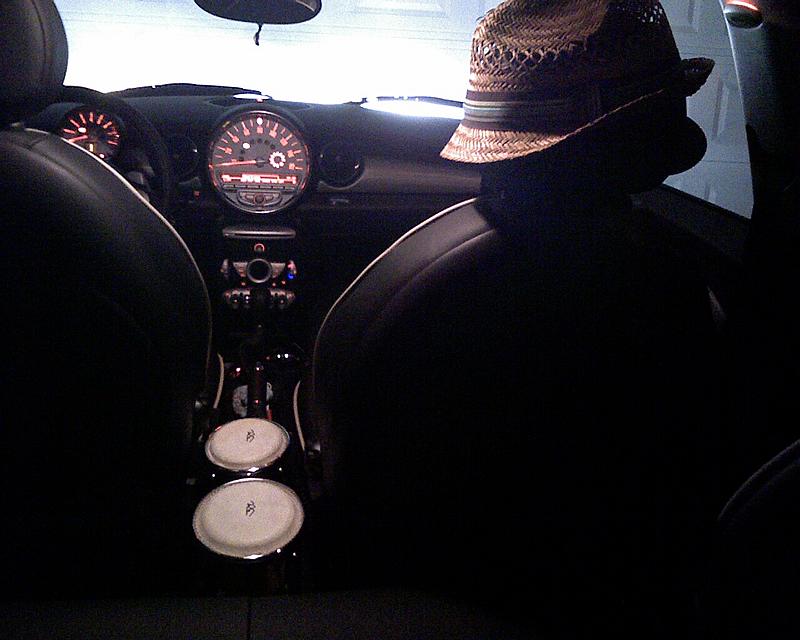

Sorry for the lame picture quality. These are off my phone.
1st pic: I made some seat pulls out of an old guitar strap. They're black vinyl with a white offset stripe. It was a great looking strap, I just never used it because it didn't match any of my guitars At least it matches well with my seats now. I tried to get my ameoba sticker in there. It's the ONLY sticker I will allow on my car.
2nd pic: Someone mentioned squeezing a drum between the seats. I do this too! These are mini set of bongos. I wear a lot of hats and I found my circular headrests to be a nice shape for holding hats

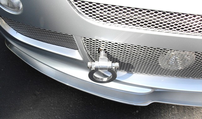

Custom aluminum spiltter and hook polished. M7 grills cut out to fit over fog lights, also cut out rear aero and put in M7 grills

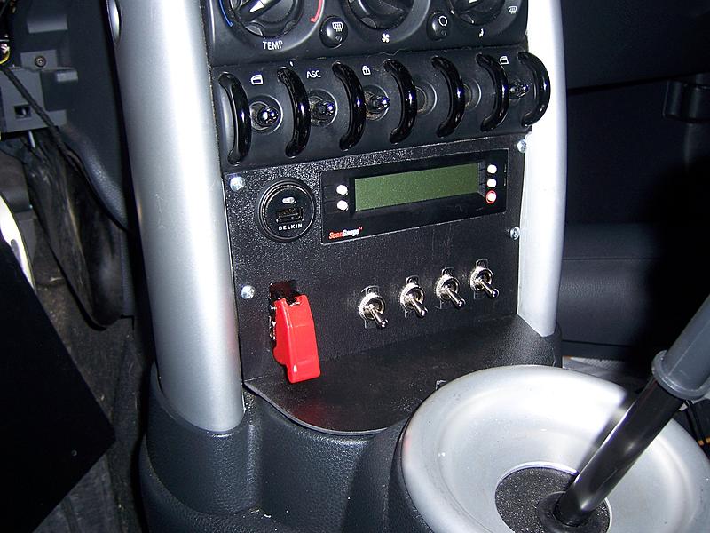

New Addition
After realizing how little I actually touch my head unit, I decided to move it to the glove box. I can control what I need via the steering wheel, and the Harmon Kardon Drive and Play and Sirius components. Having completed this move, I used some left over ABS to fabricate a DIN gauge panel to replace the head unit in the center rack.

that's pretty happenin
What's the **** to the left of your ScanGauge? And what are the other toggles? just curious

The **** is actually just an insert in a 12V accessory port. It used to have a Belkin USB port plugged into it, but somehow I lost that. The "Bombs Away" switch is for the Drive+Play/Sirius. All of the switches were originally going to have indicator lights, but the bracket holding the Scan Gauge II got in the way of that. I figured that since the audio components were the most likely to be left on, I'd make that switch stand out. With the addition of the gauges (the toggle panel was built in May), I rewired the entire assembly. So, from left to right we have Audio, AC Power [USB] Port & Gauges, GPS, Outer Driving Lights, Inner Lights (Alta Light Bar). The wiring goes into a double 4-1 hub - the positive side going to the positive battery terminal under the hood. The negative runs behind the euro shelf to a cut-off switch mounted therein (with an indicator light) and is then grounded into the frame behind the dash.
My own little spaceship.

Nice work!
I like the cutoff switch, too...

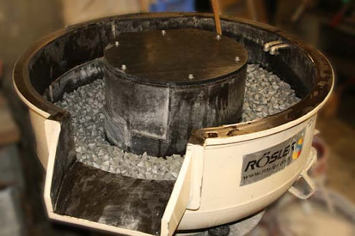

What did it take to do this? Just a few hours and a little elbow grease? What polish did you use. This is one thing I've always wanted shiny on the Mini.

you need one of these:
a giant metal tub ( fittet with some giant vibrators ) filled with ceramic abrasive stones ( dont know what they are called in English )
the only thing i did myself was building the steel plate to mount all the parts i wanted to polish ( you can see that in the first pic you quoted )
tough the machine i used looked more like this:
also used to polish wheels
