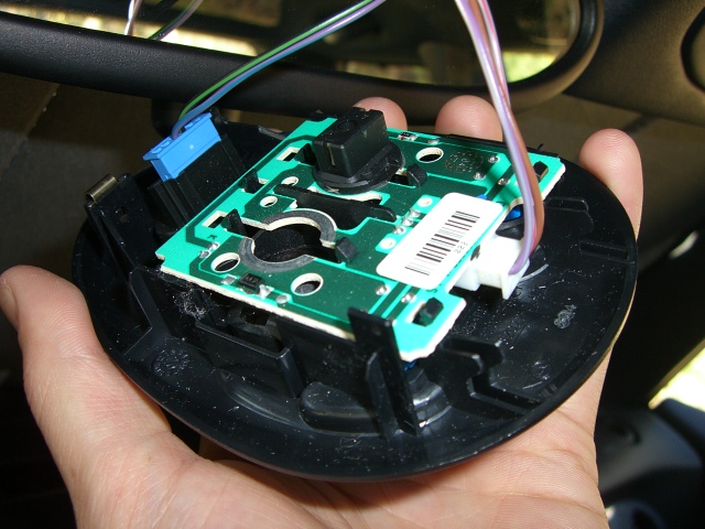

The entire console that houses the map lights, airbag indicator, and waterfall lights can be removed without tools -- it may hurt your fingertips but it's better than scratching the plastic with tools.
Simply push towards the windshield while pulling down on the back (boot-ward) end of the light console. This compresses two metal springs on the front end of the unit and creates clearance for the bevelled plastic clips on the back end to come free of the headliner. Then -- voila! -- the whole thing falls out.

The map bulbs are mounted in sockets that come free by rotating 90 degrees in either direction. In the photos, the sockets are the black plastic things sticking out from the circuit board (the driver's side socket is already removed). If you're installing LED bulbs, test them now while you have the console removed so that if they don't light you can simply rotate the socket 180 degrees to correct the polarity.
To replace the light console in the headliner, insert the back, plastic-clip-end first and then push up on the front end to pop the metal springs into the headliner.
