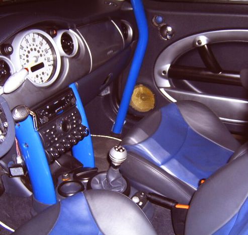

heres a pic of my interior (its a work in progress as you can see).Last week I painted the door insert bars satin black as well as my shift ring, ashtray, and cup holders. And I paintd my center console tubes blue to match my roll cage and seats. I also dyed my headliner black.
