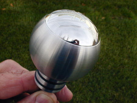

Doug Whalen makes the best shift ***** I've ever seen. They feel perfect and really improve the shifter feel. You can also have him do a custom design on the top. Here is the **** he made of me.
Attached Thumbnails Shift knob advice, maybe new shift kit too-gambill1.jpg   Shift knob advice, maybe new shift kit too-gambill2.jpg
