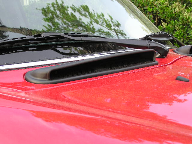

I recently installed a set of BFP cowl scoops. I liked the look of the Oricari cowl scoops but went for the BFP units because they were already molded in black ABS and I would not need to mess around with painting.
The photo on BFP's website made the scoop look as if it had a fine pebble grained texture. This I assumed would match with the wheel arches so I was not concerned by that. The scoops also looked to have a thickened leading edge. While I did not like the edge, I went with the purchase anyway.
I am delighted to say that I am happy with the purchase all around. First, the scoops are well built and very sturdy. They have a satin smooth surface texture (due to some mold changes that were put in place after the photo was placed on BFP's website). The thickened leading edge is actually a protective rubber cover that can be readily slipped off to reveal a rather sharp edge. The covers protect this edge from dings during shipping and installation.
The units snap into place, do not rattle, and (in my opinion) look good. The top sits higher than the Oricari scoop which, while not as stylish, may be more functional. In front view, the scoop is taller toward the centerline of the car which is in response to trying to get the maximum front opening area without putting the scoop in conflict with the opened hood.
The driver's side scoop had a "snorkle" tube designed to drop air immediately in the path of the air cleaner. I used a Dremel to cut this down a bit to clear my Alta CAI.
I have attached a few photos.

just a heads up on a problem I had with this product when mated with Alta's CAI: here in the Northeast ,if you do any driving in snow, you wind up ram airing snow and ice directly into your intake and thence into your throttle body .I wound up with a water in the throttle body, which froze into a chunk of ice once the car was parked at work ,rendering the car undrivable when I came out to drive home.I know this to be a problem with Alta's design of removing sheet metal and exposing the filter to direct contact with cowl intake air. JockOriginally Posted by REDWORF

Aesthetically they look great
. Did you leave them unpainted? IS that the finish they come with? Looks good :smile: You wouldnt by any chance have any picstures standing a little further away from the car do you?
Thanks, looking good
Thanks for posting the thread/pic's.
I'll chime in… want to see what they look like from a little further away - a more natural vantage point. It’ll give better perspective as to how they incorporate with the bonnet of your MINI.
So far... looks very good

Living in Southern California I am not too worried about ice and snow but your point is well taken as is the comment about the possible influx of rain water. I am guessing that one would gets some of that even with the stock cowl vent, at least a low speeds or when parked. I am considering cutting the "snorkle" back a little further and installing a baffle that will allow air to circulate around to the air cleaner but will (hopefull) condense water out and induce it to drip straight down. I am guessing that this will now require a drain port and drip tube from the bottom of the stock air box that supports the Alta CAI.

Thats how the stock cooper intake deals with water since it gets its air from the front grill....there is a 'J' shaped baffle where water collects.Originally Posted by REDWORF

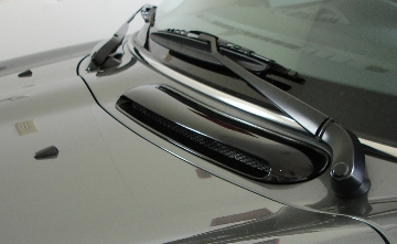

My recently installed scoops...
A "little" pricey, considering they need to be painted and all but well worth it for both the look and the air flow
