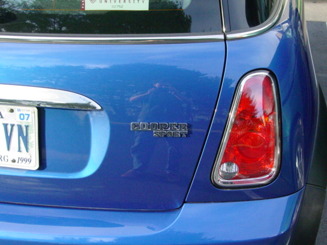

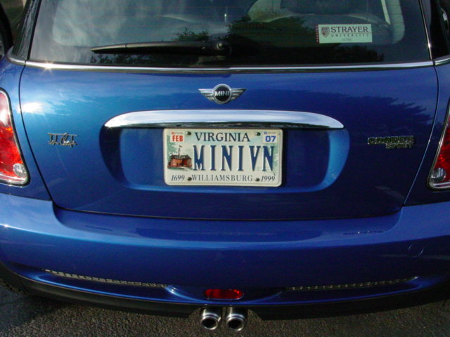

We removed our Cooper S badge and replaced it with the Cooper Sport badge.

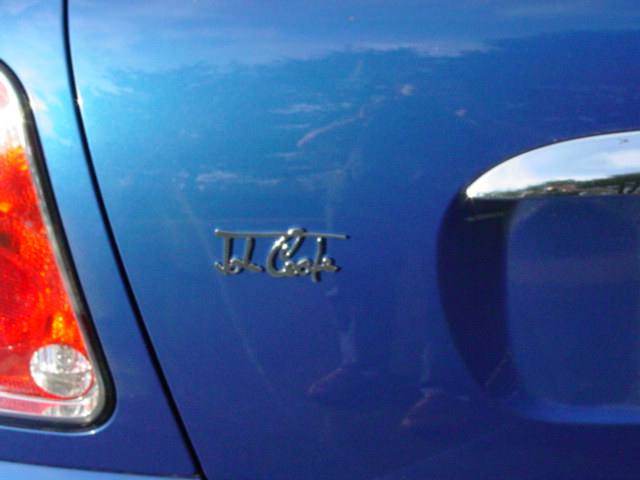

Here you go!

Install tips... Use dental floss to remove the letters. All with the exception of the O's will probably come off really easily. Use a hair dryer to heat up the letters a little to loosen up the adhesive if you have any problems removing any of the letters.
We used Simple Green to take the wax off the car in the areas that we wanted to place the badges.
The John Cooper badge was a snap to get on and appears to bea great fit.
I'm keeping a close eye on the Cooper Sport badge. It's designed for a Mini with a flatter boot so it doesn't conform to the boot on MINI as well as I'd like it to. The R and the C don't appear to be sticking to the car very well, however the rest of the badge is on pretty securely so it'll probably be fine.
If you consider the John Cooper badge from P & L I'd suggest spending the extra money and getting the chrome one with the adhesive. The stainless steel one has an annoying tendancy to rust in the winter, something I didn't know before I bought it and stuck it on the car. If I had, I would have painted it first.

Lookin' good, mbabischkin!
dental floss, huh? Nice one.
