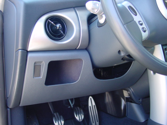

Originally Posted by tradiuz
Not a standard feature in the US due to DOT regulations.
But not outlawed like the Euro knee bolster
Attached Thumbnails Parcel Shelf Install Problem 05 MCS-knee_bolster_cubby.jpg
Old May 27, 2005 | 01:03 PM
MINIAC's Avatar
MINIAC
Joined: Jan 2003
Posts: 2,319
Likes: 94
From: Tsunami Zone
The Euro knee bolster is NLA from US dealers ...
I bought mine from someone who managed to order two from a US dealer before MINI USA put the kibosh on doing so around mid-2003.
I know the factory has screwed up on several occasions and fitted these on US spec cars:
http://www.mini2.com/forum/showpost....96&postcount=4
In most cases the dealers had to remove them.
