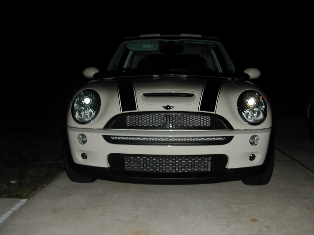

Oh, dont give up..... I followed these instuctions.
https://www.northamericanmotoring.co...ad.php?t=27619 use a dremel.
remove a small portion of the outside of the the top and the bottom of the lower grill. I also had to cut a few more slots in my bumper. I used a box knife fro that part. here's mine

Thanks that looks great!
