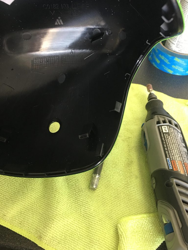

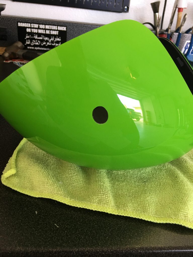

Mine had the indent in it, so I drilled a small hole then enlarged it little by little with the small dremel sanding band.

Anyway, I created a template with painters' tape, marked the spot on the new cap and cut it out with a Dremel
VOILA
