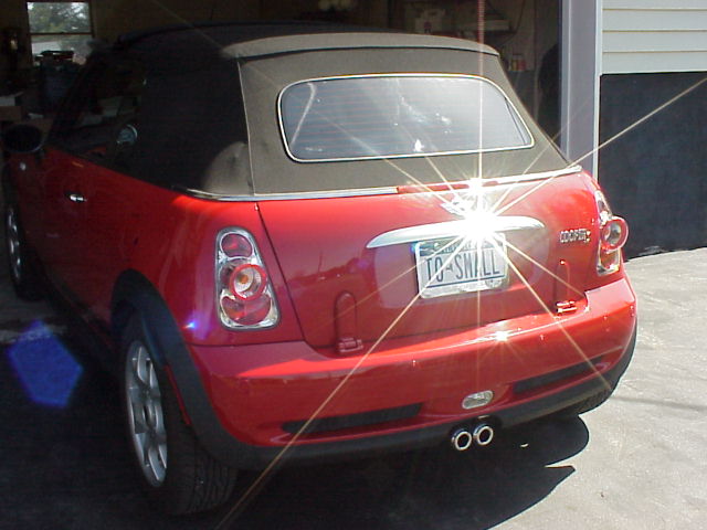

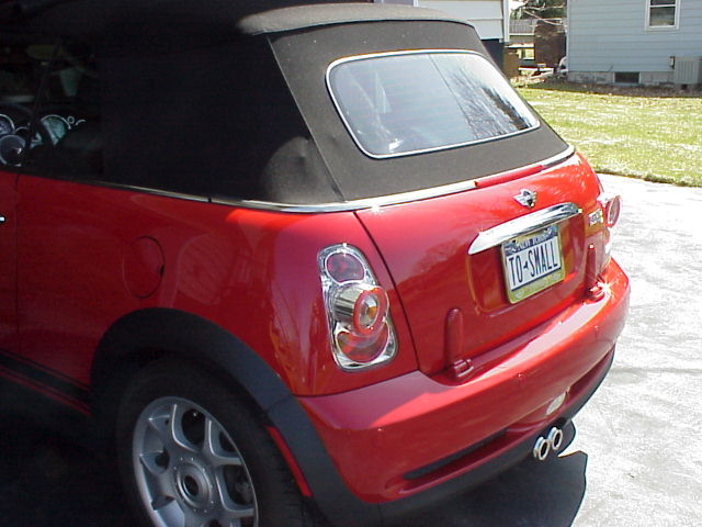

I installed the Custom Tail lights on my 05 that fit 02 - 04 and installed a reverse light in the bumper like the 04's. I wired it so that the upper and lower red lenses are tail and brake lights and the center amber light is the directional. Check out the pics.

Hmmm eww

This looks good- far too adventurous for me, I am not technical enough. I also had enough (electrical) problems with my '03 that I felt I would be courting problems if I was tempted to do any electrical work myself, they might have interpreted that as a means to void my warranty. I instead ordered the rear fog light, and am satisfied with that as an alternative for the moment. Got stopped by a cop a week or so back, he wanted to be assured that it was a "stock" item and not an "owner-installed" alteration. At least I got confirmation that it does the job...

Interesting. In anticipation of getting my MCS soon I contacted a NAM sponsor to inquire about after market tail lights for a 2005 and received a courteous response explaining that changes were made to the 2005 and therefore the 2002-04 lights would not work. I shall inquire again. Thanks.
