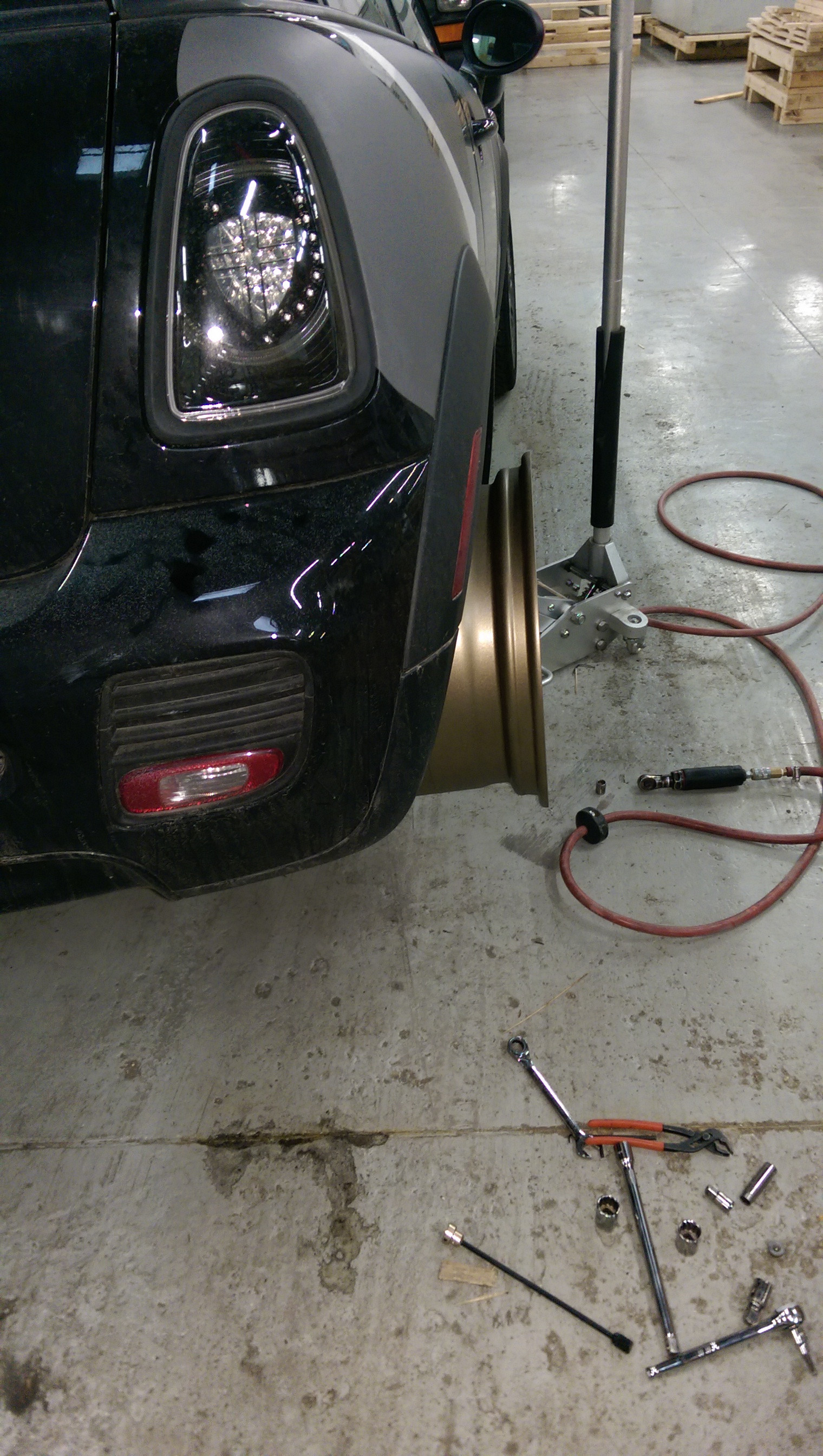

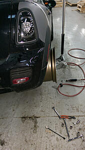

Old Jun 16, 2014 | 11:00 AM
JChristopherWalken's Avatar
JChristopherWalken
Joined: Oct 2011
Posts: 43
17x9 +22
