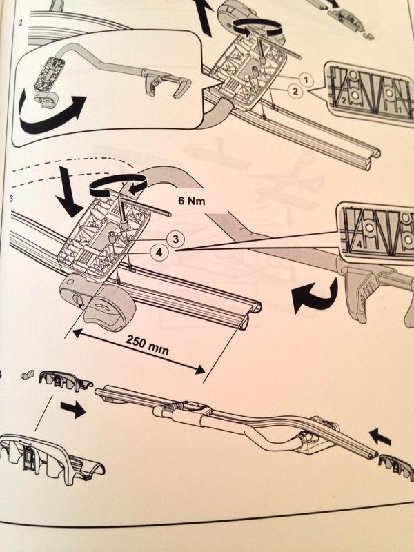

I swapped the arm around on mine and use it on the drivers side. The instructions that are included with it actually show you how.

I got mine used and cant find the instructions online. Any Help with the instructions would be appreciated.

With no access to a scanner the best I can do for you is pictures. I can do that later today.

Hope this hleps ya!

Awesome! Thanks a bunch! I'll give it a try when I get home tonight.

It worked! Thanks again crustafur!
