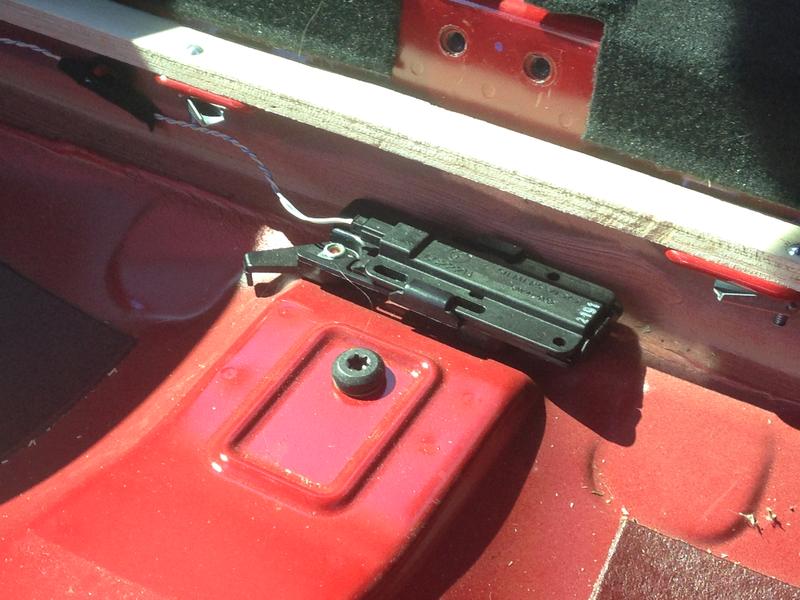

4. Remove the center mount for the rear seats. It is two Torx bits that are covered by the rear seats. Remove them and it will come out easily.
5. Measure and drill new holes in the hinge to fit where the center mount was.
6. Attach the drilled hinge to the cover.
7. Bolt the hinge and cover to the existing mounting point, and ensure everything fits. The fit may not be perfect, but you’ll want to leave some room around the edges for carpet.

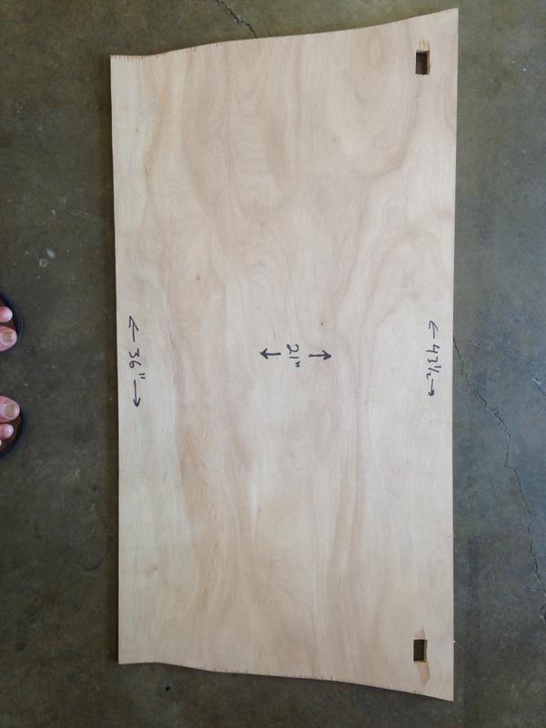

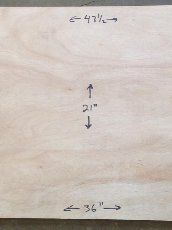

Pulled the seats out and used the bottom cushion as a template.

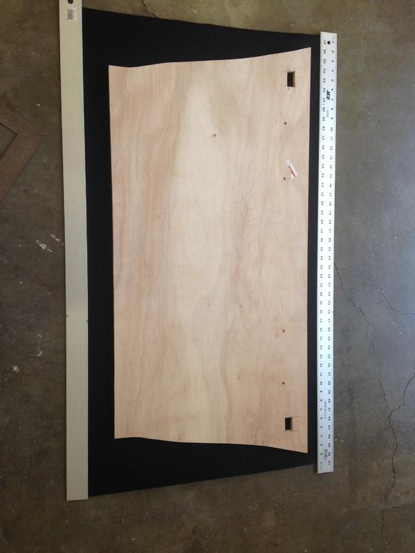

Cut a 2" x 36" piece of the birch to use as a base for the rear of the piece. Used two toggle bolts through the seat bottom loops to hold the base. No holes drilled.
Trimmed the birch to fit so it had about 1/2" clearance to interior sides of car. Need room for carpet covering. Marked front and notched the birch so that the mount loops come up through.
Cut the automotive carpet so it was 4" wider than all sides of the birch, sprayed adhesive and applied the carpet. Took a little time and got messy but good result.

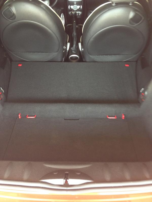

I ordered the pins from Amazon. They are 3/8" quick release pins 1" grip with a ring. These will slide through the front loops securing the main birch cover to the car.
Pulled old carpet from cross brace in rear and used old carpet as a template to cut out for rear cargo space loops then wrapped that area with the carpet tucking it in under birch piece, sides and rear cargo cover. I didn't glue this in case I want to reinstall the rear seat at some point.

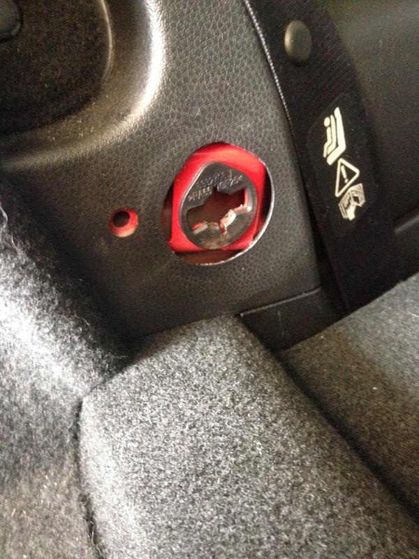

Finally to cover up the rear seat holes on both sides of the interior, cut two small pieces of carpet and stuffed them behind the plastic.
Hope this helps others trying to do the same project. Nice and solid and now my golf clubs fit no problem
