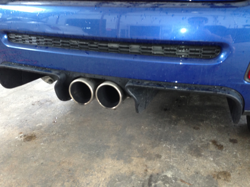

Today I installed the GPII diffuser on my 2013 MCS with JCW package. It was pretty simple and if your skinny enough you dont even need to lift the car. The hardest part is getting the two tiny screws on each side, which I still have been unable to get back on.

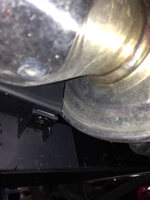

Now, the unexpected part... I have an Invidia Q300 exhaust and the diffuser would not fit into the bumper because the muffler is bigger than the JCW exhaust. I had to shave off (literally. i used a razor blade) the plastic in order for it to fit.
After a bit of frustration and hard work the diffuser looks great.
Also!!! I ordered it from the service and parts department at the dealer. The kit did not include the screws. I removed the screw that secures the bumper and bought 10 of those. You'll need 10 total, so you could just get 9
have fun!

Te part where it meets the muffler was curved backwards. Thats where I had to cut. It was getting new shoes thats why the wheels were off.

Could you have put a spacer on the muffler mount to angle downwards a bit?

Maybe, but I think that the exhaust pipes would then be touching tu upper part of the diffuser. It would've been a tight fit.
Also, the difusser has an inch wider opening for the pipes which makes the Invidia look a lot better since it doesnt look as crowded.
