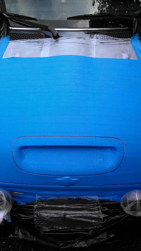

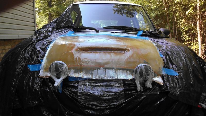

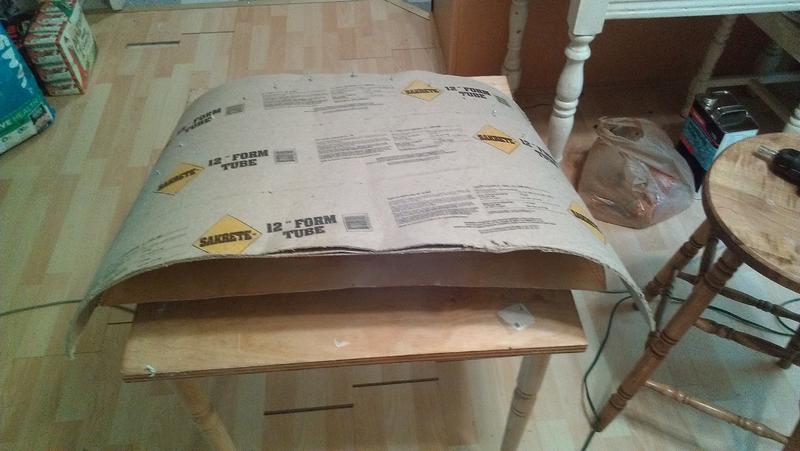

So I finally pulled the trigger on the construction of the "megalo-scoop". Here's some pics of the hood casting process..... first a couple layers of Glad press-n-seal (this stuff is the bomb! I use it to mask off for detailing and plastidip applications), a layer of painters tape and then waxed the hood (as a release agent).
Attached Thumbnails IC scoop bug finally bit me!-2013-07-28-10.12.02.jpg   IC scoop bug finally bit me!-2013-07-28-10.12.13.jpg   IC scoop bug finally bit me!-2013-07-28-10.12.37.jpg

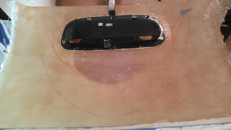

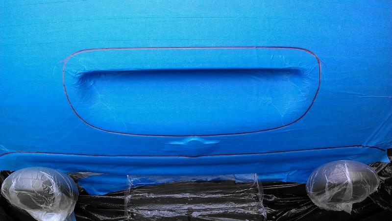

Then.....
Then I applied the first layer of woven fiberglass cloth and traced some shapes into it using common household stuff, then applied the resin.

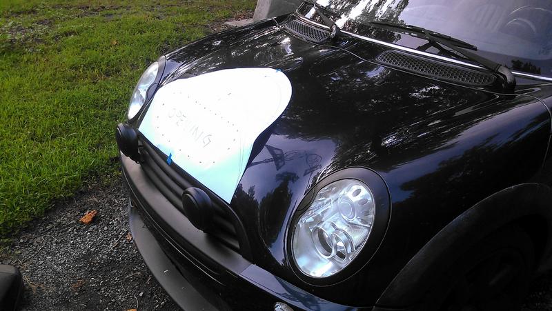

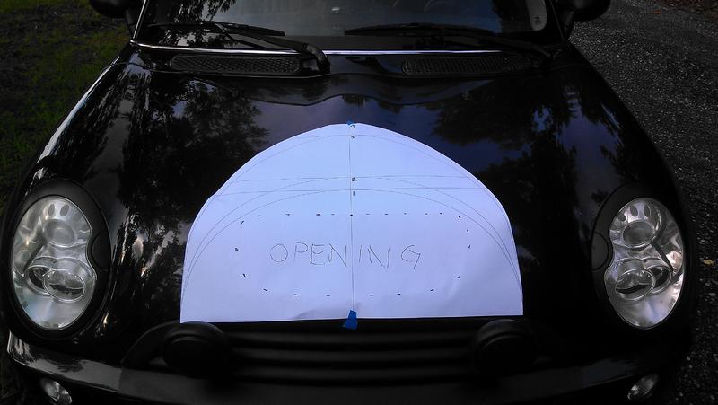

Help me choose......
I need some help deciding on a distance up the hood. Please realize, I've already decided on the shape (using a 12"dia. split and stretched sonotube as the mold for the top of the scoop) and anything beyond the actual scoop hole is purely aesthetic. I put numbers on the distances, they're not actual measurements, just a number for y'all to go by when commenting. Also, the further up the hood the scoop goes the taller the "mouth" of the scoop. Please help. Thanks.
Attached Thumbnails IC scoop bug finally bit me!-2013-08-01-18.49.41.jpg   IC scoop bug finally bit me!-2013-08-01-18.50.05.jpg   IC scoop bug finally bit me!-2013-08-01-18.50.18.jpg

I'm most definitely interested to see how this turns out! I love custom fabrication and the MINI is an absolute perfect choice for it, easily inviting all sorts of styles.
Question: If you went with 3 instead of 2, how much taller would the "mouth" of the scoop be? Knowing me, I'm a "go big or go home" extremist, so I would go with 3. Of course, that's very dependent on how tall the scoop opening would be.

I went with 3.......
I went ahead and went with 3 due to lack of response after 300 views and no replies....... Thanks for replying, I was beginning to wonder if I was speaking piglatin or something? Of course, I know that this is an extreme attempt at a scoop improvement and not every MINI owner may be on board. It will definitely be "extreme" and one of a kind. I've done my research and nothing like this has been tried. Definitely a "velocity stack" kinda design to funnel the air into the existing scoop opening.....

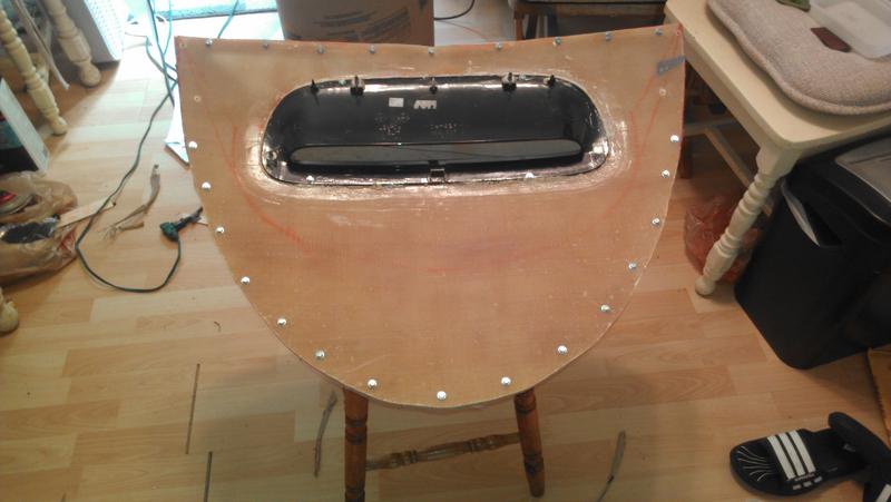

More progress.....

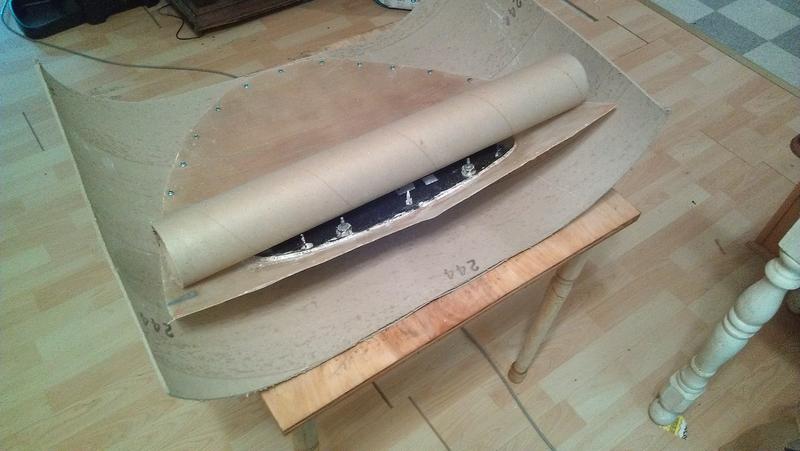

So I've got a few more pics of my progress. Looks pretty unorthodox huh? I've always been the type to use common materials I see everyday instead of going out and buying/having the technically correct tool or ideal methods and materials for the job (back yard/shade tree installer). I see it in my head and just start making up a progress to achieve it. Yes, I'm rambling...... rainy Saturday....... I'll just keep posting pics and shut up. Mabey I'll get more done.
Attached Thumbnails IC scoop bug finally bit me!-2013-08-02-16.43.04.jpg   IC scoop bug finally bit me!-2013-08-02-16.42.22.jpg   IC scoop bug finally bit me!-2013-08-02-16.42.11.jpg

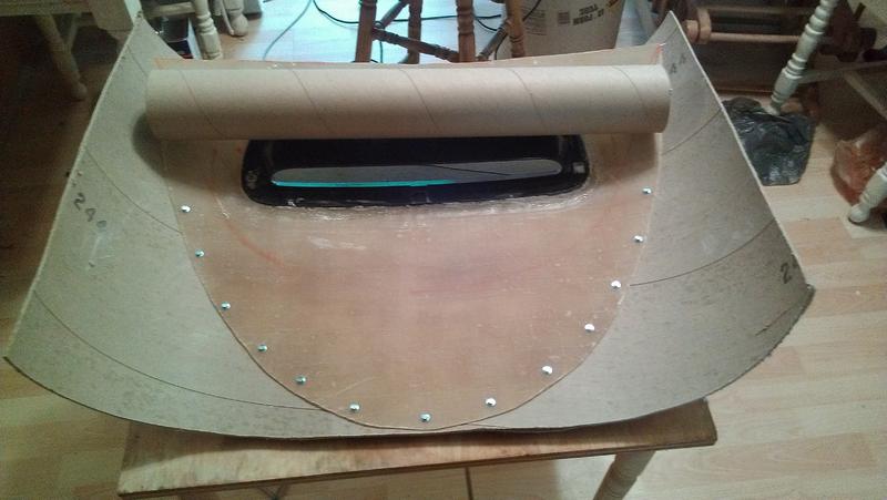

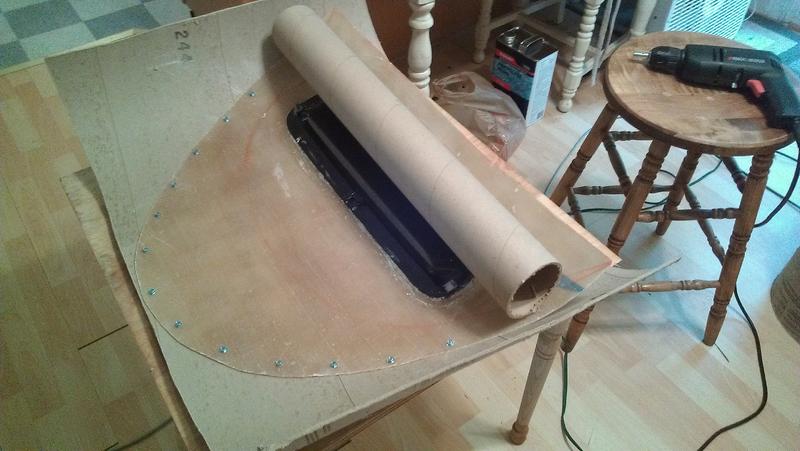

More......
More Pics..... The 4" cardboard tube is there temporarily to keep the fiberglass base from flexing while trying to stretch the split sonotube over it.
Attached Thumbnails IC scoop bug finally bit me!-2013-08-03-17.41.34.jpg   IC scoop bug finally bit me!-2013-08-03-17.41.44.jpg   IC scoop bug finally bit me!-2013-08-03-17.41.55.jpg

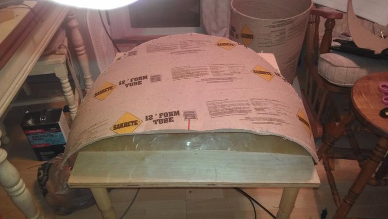

More......
And some more. Starting to see where I'm going with this yet?
Attached Thumbnails IC scoop bug finally bit me!-2013-08-03-17.42.12.jpg   IC scoop bug finally bit me!-2013-08-03-17.43.42.jpg   IC scoop bug finally bit me!-2013-08-03-18.37.45.jpg

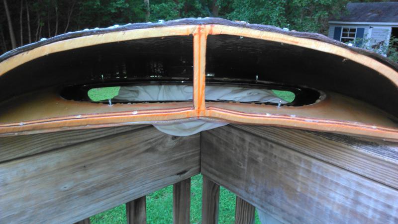

Got everything trimmed up and added a center "grille/support" cause it just didn't look sturdy enough (who knows how much wind force this thing is going to have to stand up to at 1000mph.... ).
I'm going to pour in some resin into the interior around the edges for strength then let the rest pour over the sonotube interior for strength and some moisture resistance before resinating/glassing the exterior.
I also had an idea about adding another "hump" down the middle of the scoops top exterior (kinda like a Bazooka Tube subwoofer but way more subtle?) to kinda match the hump down the middle of the existing hood. Mabey it'll help tie it all together. Here's some more pics.....
Attached Thumbnails IC scoop bug finally bit me!-2013-08-04-16.27.27.jpg   IC scoop bug finally bit me!-2013-08-04-16.28.32.jpg   IC scoop bug finally bit me!-2013-08-04-16.29.12.jpg

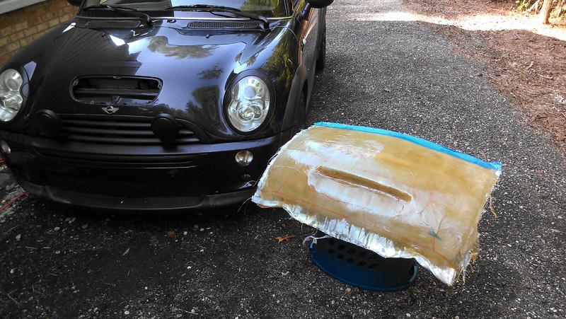

Resin......
Used a quart of resin poured into the inside and rolled around and around and around till then entire interior of the unit was coated. Its well sealed now and moisture proofed. Time to created the "funnel".
