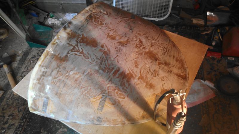

Time for Bondo
Sanded everything down good enough for a coat of bondo.... here we go.........

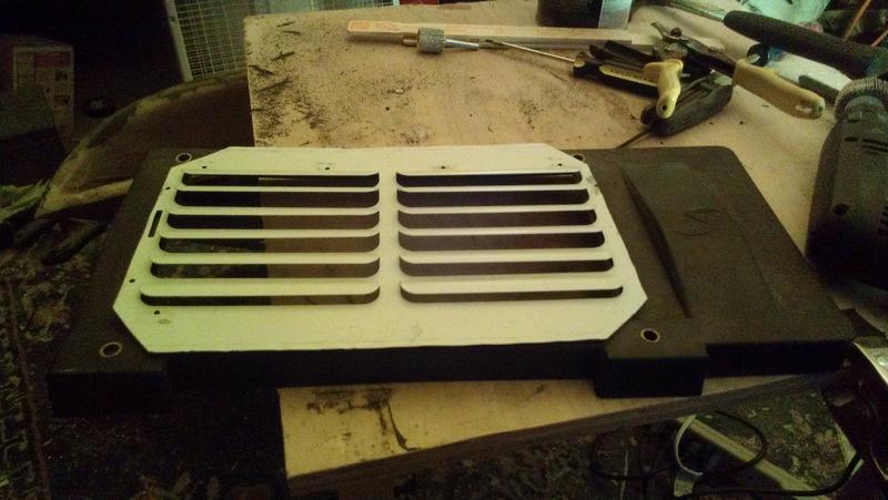

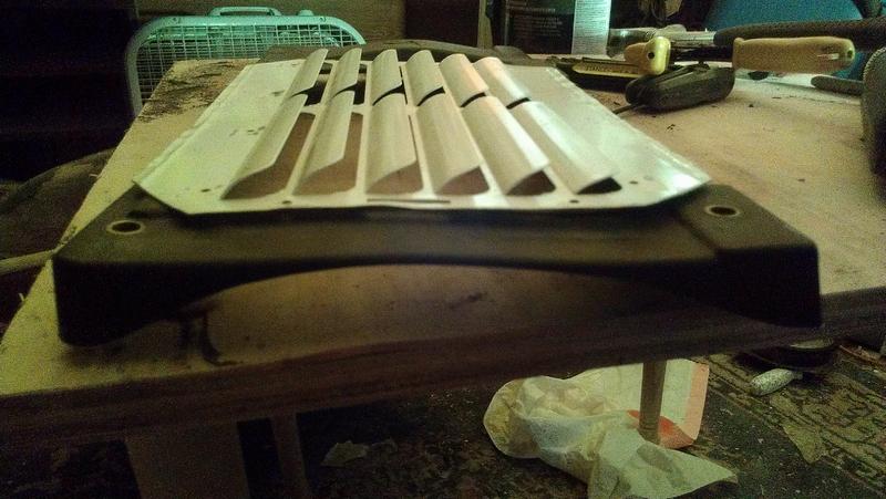

From: Hillsborough, NC

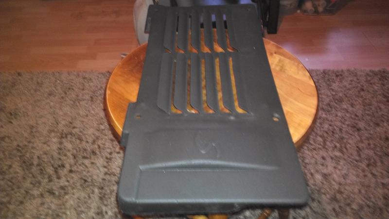

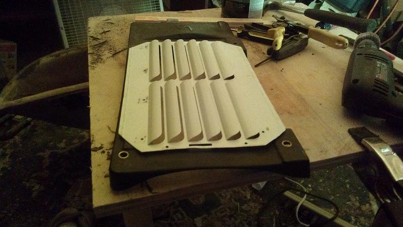

Another project to fill in between sanding
So since I had some time to kill between filling and sanding, I decided to start the OTHER project that goes along with the new scoop. Yep, the IC diverter mod.
I'm going to make each fin progress lower to higher from front to back. Hopefully with this along with the scoop, I should get some more flow through the IC.
Attached Thumbnails IC scoop bug finally bit me!-2013-08-15-20.25.10.jpg   IC scoop bug finally bit me!-2013-08-15-20.26.02.jpg   IC scoop bug finally bit me!-2013-08-15-20.26.13.jpg

is that attic venting? =)

Kinda?
It's a supply grille from Lowes (Home Depot doesn't carry one with bendable fins), trimmed down to fit.
I'm a Mechanical Designer/BIM Manager for a small PMFPE engineering firm (I design and coordinate HVAC, Plumbing, Sprinkler and Electrical systems for Healthcare and Hospitals. So basically, I have to design systems to move air around inside buildings.) and it just bugs the hell outta me that the stock IC diverter only has the single little fin in the middle and requires a "pressurized plenum" to get the air to move through the IC. I just always thought the air needed to be guided or shaped to blow through the IC (higher flow and velocity). We shall see.

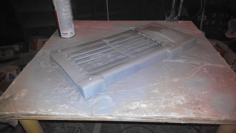

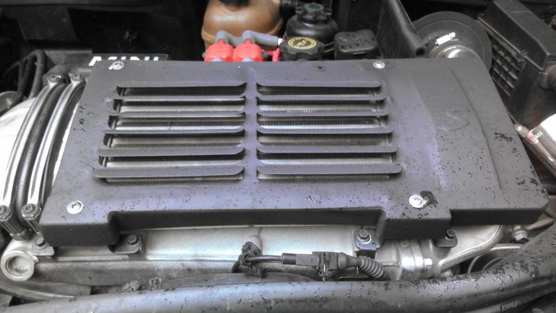

A couple of pics real quick.......
Had a few drinks last night and didn't get as far as I wanted, but here are a few pics from last night.
The etching/filler primer was still wet, I'll start sanding on it tonight as well as some more sculpting on the IC diverter.
It looks rough now...... but it'll get better, I promise
Attached Thumbnails IC scoop bug finally bit me!-2013-08-20-00.07.20.jpg   IC scoop bug finally bit me!-2013-08-20-00.07.02.jpg   IC scoop bug finally bit me!-2013-08-19-23.48.57.jpg

I'm sooooo ashamed.....
When I decided to modify the IC diverter, I was just going to leave it kinda "rough around the edges" looking. Like the first pics I posted of the mod with the white fins and such. But...... I showed it to a friend of mine and he was all "you should take that bondo glass and smooth out" over the screws I used to mount it.... Ummmm....... NOT! What a pain it's been to do that. So, I gave up. It'll still work physically like I wanted it to but visually, UGH
So I just decided to give it a good few coats of Plastidip until I can find a used stock diverter and do it over again. Live and learn. I think I would have liked it just fine all "Mad Max" style n shtuff. Scoops looking good though.
I'll post pics of the diverter after the Plastidip here soon.

The Franken-attempt pics......
Nuff said. At least it's under the bonnet until I can rebuild one.
