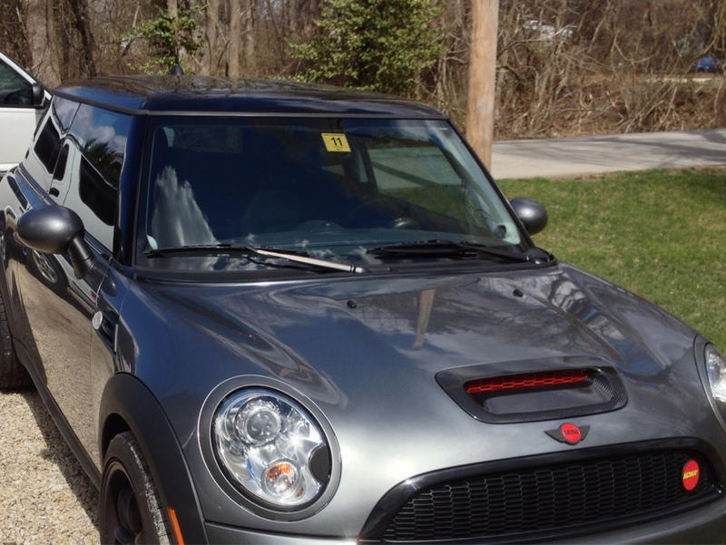

This was after buffing with compound and 2 more coats of clear. Just have to polish them. It was a bit overcast this morning.

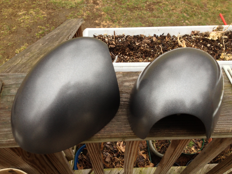

Posts: 1,180

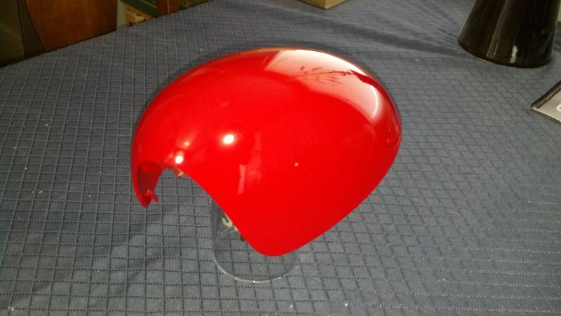

I painted my mirror caps last Friday and they came out amazing! The red I used matches my red hash marks perfect.
1: Pulled caps off (very carefully)
2: Washed with dish soap (removed debris and grease/oils)
3: Dry well
4: Sanded the factory white caps with 600 grit until there was no sheen left from the factory paint job. This ensures a good bond
5: Took a lint free cloth and a ammonia free glass cleaner and wiped down well. You do not want lint or debris on the cap. It will show in the primer/paint
6: Primed with 3 light coats. Ensure complete coverage. Sand with 800 grit lightly to remove any imperfections
7: Prime again if needed
8: Lightly sand again if primed again
9: Wipe again with ammonia free glass cleaner and lint free cloth
10: Paint with chosen colour. Multiple light coats will prevent dripping/sagging paint. There is a fine line between light coats and too much that allows a smooth finish.
11: Let each coat dry before adding a new coat. Wet sand if necessary and only sand once a coat is completely dry.
12: I did not have to sand any of my final coats.
HINT: Paint when the temps are cooler (70 to 75 degrees) to prevent paint from drying too fast. Paint needs to settle and give you a nice smooth finish. A little humidity helps too.
I'll have pics of the cap on my car as soon as the snow around here melts.

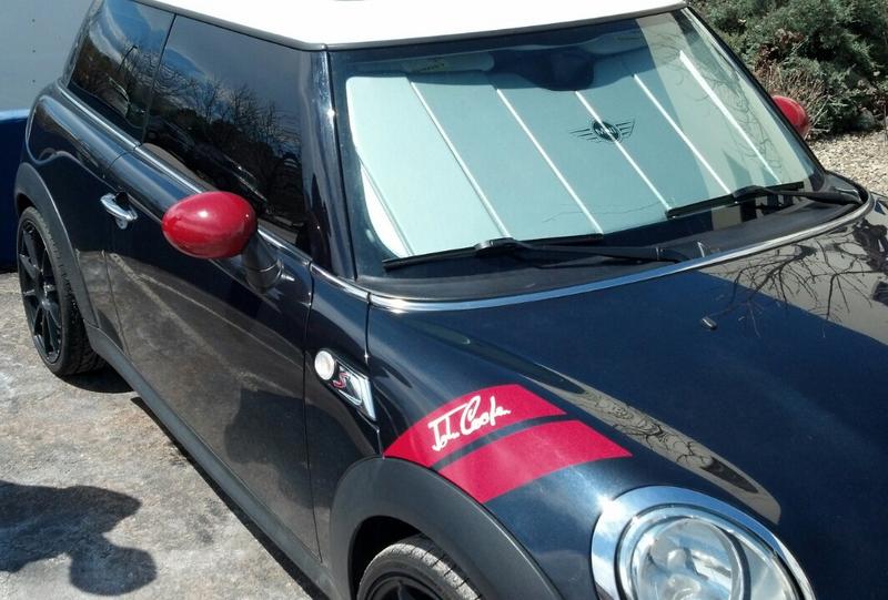

Sorry for the dirty car. It snowed like crazy here in the last couple days and everything is melting.
So as promised...my finished mirror caps.
