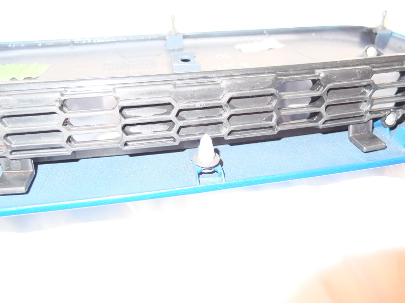

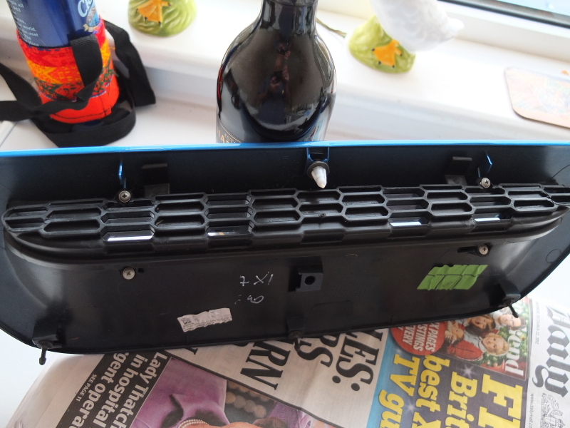

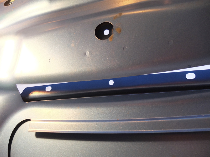

Does this help with places to pry? It might be the same...Real.OEM will confirm.
This is the plastic scoop from my Feb '12 R56 MCS hatch.
I was nervous after hearing of other's disasters but IMO you have to be brutal and decisive.
It might help to show what could possibly be broken and where to pry for maximum effectiveness. The underbonnet plastic rivet (not shown but it fits the hole is in the middle of the part) needs to be removed first. This seems to be what most people forget. I used plastic trim removers and there was no damage to paintwork.

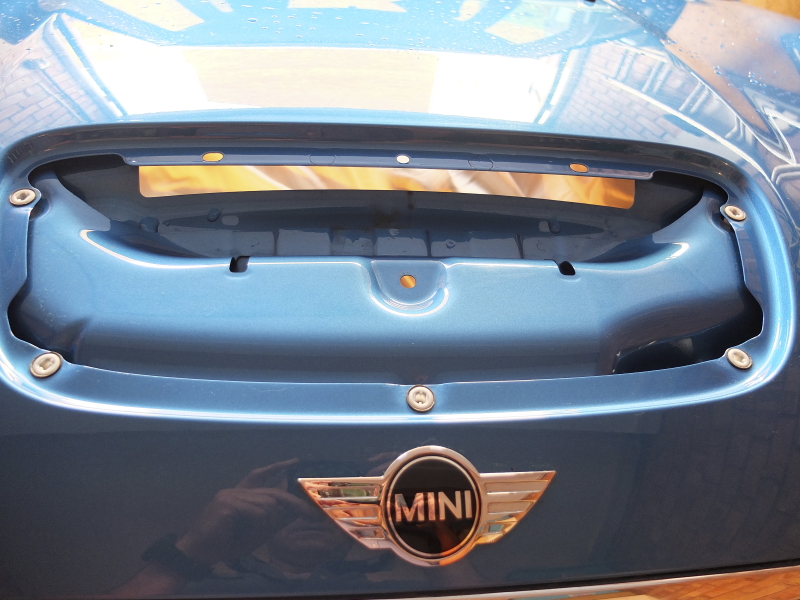

this is what im looking at
Old Feb 6, 2013 | 08:50 AM
cjm's Avatar
cjm
Joined: May 2012
Posts: 174
From: West Sussex, UK
Looks like it...

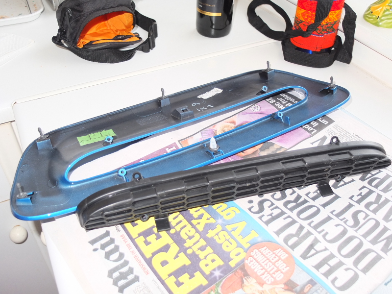

(Two more top + bottom R56 MCS views attached.)
Attached Thumbnails Removing 2013 hood scoop insert?-dscf0576a.jpg   Removing 2013 hood scoop insert?-dscf0578a.jpg

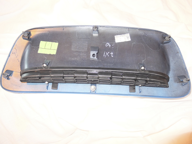

Does this pic help?
RealOEM calls it an expanding rivet.
I think I've also seen the same holding A-pillar speakers in place and those plastic-to-bodywork pieces outside the seats...

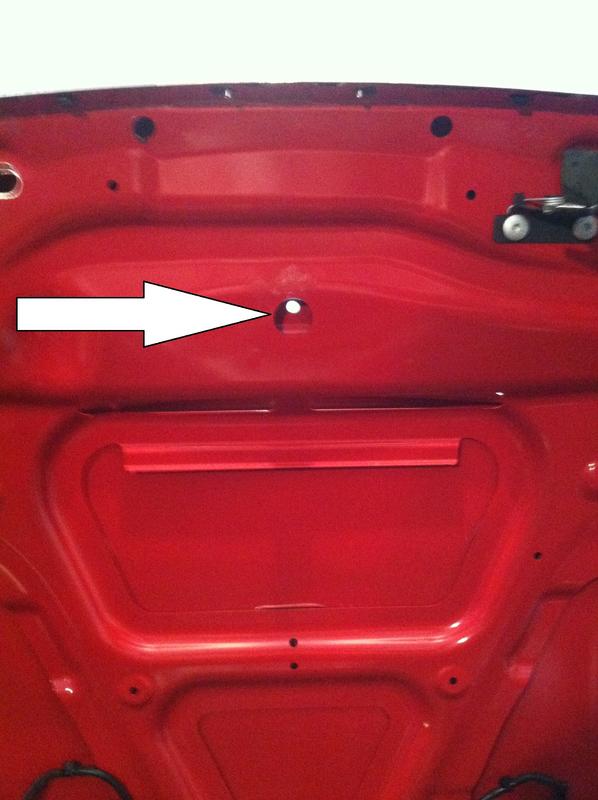

its a little hard to tell from your picture....
im talking about this one
mine was a philips head screw.....wondering if anyone knew the screw size.
EDIT: FOUND IT!....Was hiding in my engine bay.

Yes Mcameron if you turn my last picture upside down as if you're putting it on your bonnet/hood that white plastic rivet in the middle goes through the hole you arrowed, spreads out and stops it being pulled upwards or stolen when the bonnet's closed.
The others around the plastic scoop push in directly from above.
That's how it works on my N18.
Two more pics might help better:
Found it? That's how it should be! It never works like that for me, though...
Attached Thumbnails Removing 2013 hood scoop insert?-dscf0596a.jpg   Removing 2013 hood scoop insert?-dscf0600a.jpg
