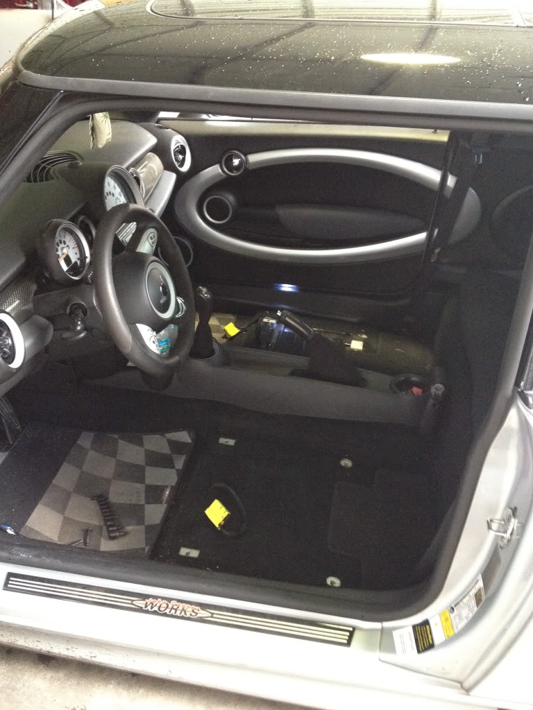

The seats removed: Name:  IMG_0483.jpg

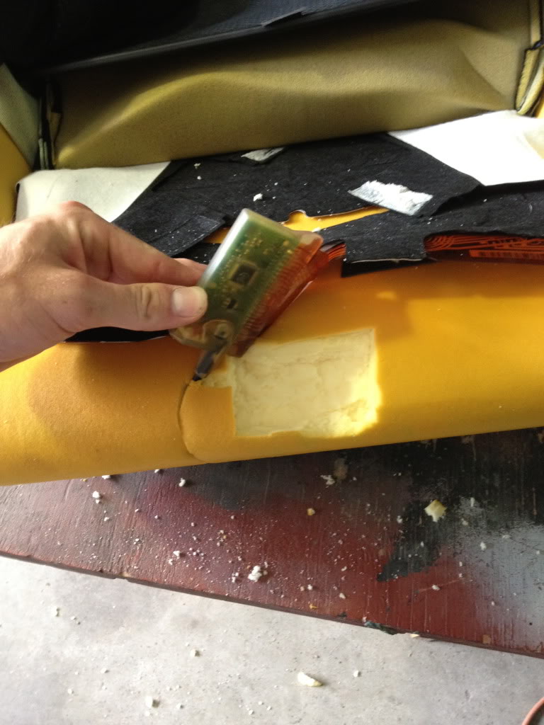

Cutting up the factory seats to salvage the weight sensor: Name:  IMG_0471.jpg

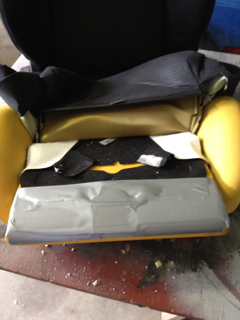

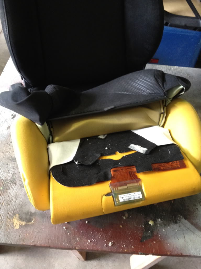

Cutting up my brand new Recaros to make room for the sensor (SO PAINFUL): Name:  IMG_0484.jpg
Some Duct tape to smooth things out: Name:  IMG_0486.jpg

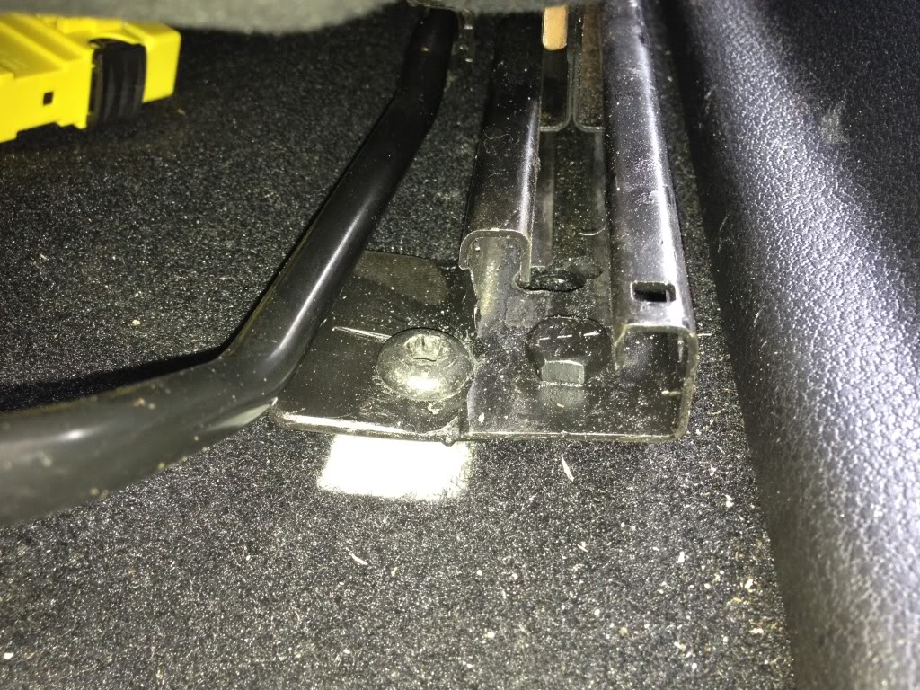

Heres where it got serious, the Modified bracket I made to match up to the factory holes. The Recaro's were about an inch wider than the stock seats, so I bolted (and welded for added stability) a plate to extend underneath the seat in which I could also bolt down to the floor. Like so: Name:  IMG_0521.jpg

In the last picture you can see how I mounted the seats so that the reclining **** was facing the interior of the car for easier adjustment, similar to how it is on the stock seats.
