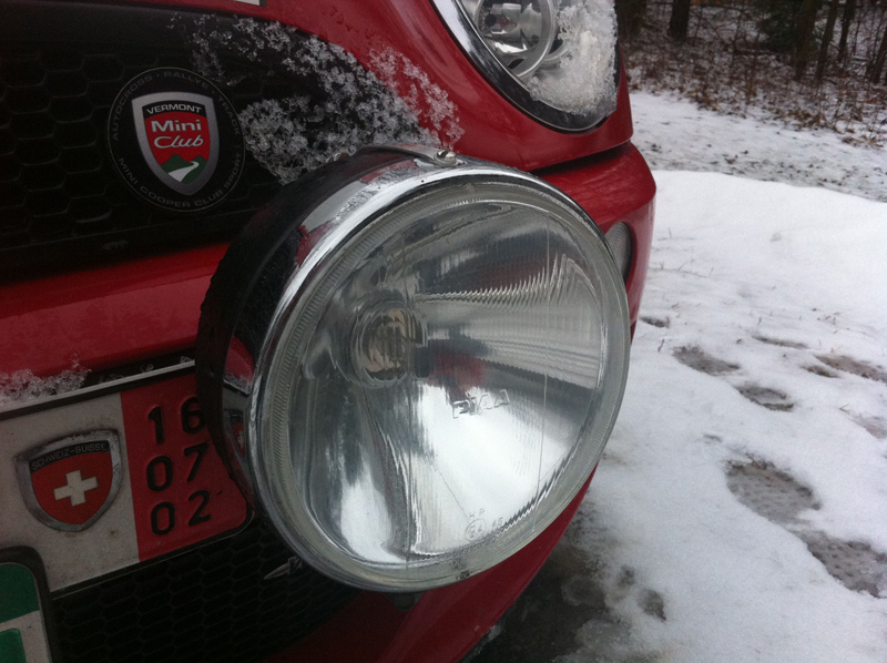

TSR, When you get a chance I would love to see these lights without the covers. Thanks, doug

Here you go.
Attached Thumbnails Driving light ideal mounting location for actual use?-img_1751.jpg   Driving light ideal mounting location for actual use?-img_1752.jpg   Driving light ideal mounting location for actual use?-img_1749.jpg
