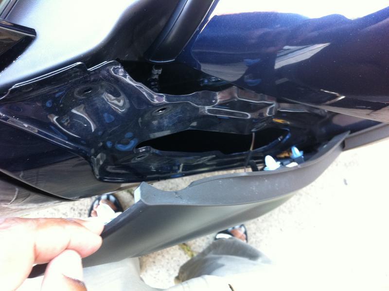

Open hood...Then using some kind of prying tool or your hand you have to pull up on the trim piece above the scuttle. Its a little hard to get to come up but it can be done, using the prying tool helps alot. Now remove the light by pressing the white tabs, if you get one out, the lower tab the top will follow. Now disconnect the light and set that to the side. Look down in the compartment you should see several white nylon fastners. These are tricky using your trim tool or what ever you have to pry with, gently pry the top from the outside. You will here some cracking but its the fastners coming loose. Repeat until you have them all out. Theres one at the very bottom along with a long piece of plastic that's attached to the scuttle. To get at that piece and free the scuttle you have to pull back the cars trim a little. After you do that wrap on. Hoped that helped a little. The trim tools I purchased from Harbor Freight, if your going to do alot of work on your car these are a must. It prevents alot of maring

White fastners from the front view looking into hood.
Last two white fastners and the grey rod attached to the scuttle.
You have to pull back the trim a little to get the scuttle out.

Hope these help sorry about the iphone pics.
Trim tool is a must.

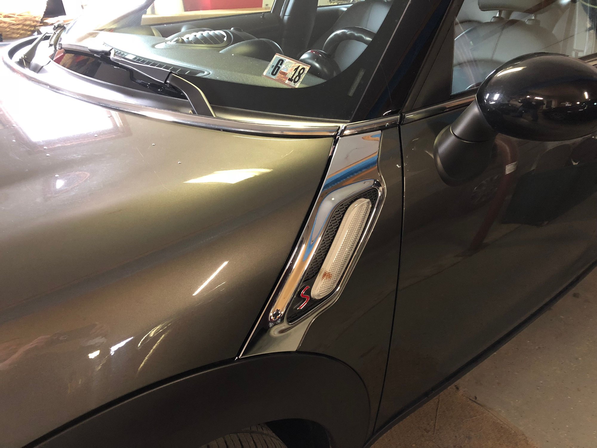

Before
After
Great write up!!! Made it so easy. I know most people tend to black out their MINIs. I like a little additional (plastic, yes) chrome. Next is brake ducts. Just don’t know yet if I want the ones with the LED DRLs or without.
