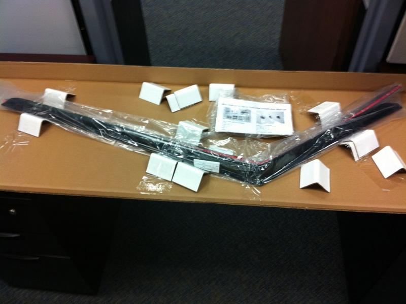

So this post is a little old, but I too have been looking for some window vents (whatchamacallits) myself and found some on eBay by a company named Restyling Specialist. Since they are the ONLY ones manufacturing these window vents for MINIs in the US that I could find, I went a head and ordered a set. Well 4 days after placing my eBay order, they arrived today in a big ole-box via FedEx.
Attached is a picture of the vents just pulled from the box. My mini is going into the shop tomorrow to get programmed for the bluetooth retrofit I just installed and a few other fixes, like the High Battery drain issue. So I will not be installing these new window vents until I get my MINI back from the shop.
I will post my install comments and photos when I do the install.

I did a ton of work on my min so far this weekend and it's just Saturday evening. I am dead on my feet. One of my mini MINI projects today was to install the window vent/visor/deflector things.
The quality is very good. Nice strong plastic, tint about 30%. I started with the passenger side to get a feel for these things. Unlike any side window deflectors I have installed before, these came with clips. The instructions were straight forward, but the clips, don't actually clip, so I did not use them. The b&w photos in the instructions are terrible and hard to make out. However, these a definitely designed for the mini, as they fit very well.
You do need to pre-measure or pre-lineup where you want these to go, cause once you peel the tape off the sticky stuff and affix these vents to the car, they can not be pulled off and re-attached!!
So I got the passenger side installed and I was happy with it. The MINI's door window looks like it is going to hit the deflector but it just misses it. It helps that the minis window pop down a bit when you open the door.
So now I am ready for the driver's side... install when OK, except I accidentally placed it a tad to low and the mini door window just barely scrapes the deflector... but it working find.
One last thing... these deflects, when installed, leave a little gap a the top front, where the deflector bends and heads towards the back the car. The kit comes with pads and instructions for dealing with this, but I thought the pads where too small, so I added more padding and little bit of clear sealant. Once the sealant dries and it is noticeable, I will need to touch it up with some black paint.
Pictures attached. If I missed anything or you have any questions, let me know.
