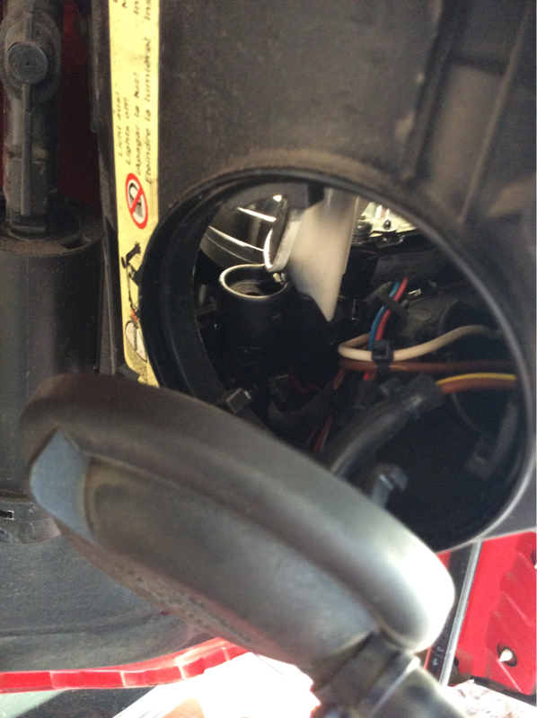

Have the same problem, that part seems to be loose but won't attach to the small ball behind

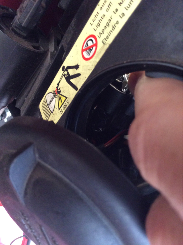

I can move it by hand, any idea on how to plug it???

The stupid plastic 3-point "ball and socket" joints that hold the heavy headlamp assembly are too weak and will allow the assembly to pop out of one or more of the joints when you close the hood too hard. This has happened on my 06 R53 passenger-side headlight twice now and I'm fed up with it.
To fix it the first time, I opened up my headlamp as when doing the "joey mod" - it was a major pain in the neck. It worked for about year since I was being very careful every time I shut the hood, but there's a very fine balance to closing the hood just hard enough that it fully latches on both sides, without closing it too hard and popping the headlight assembly loose. After my last oil change I accidentally closed the hood slightly too hard (because the first time I closed it I didn't shut it hard enough and one side didn't latch) and of course it popped the darn headight loose again.

Nothing was broken; two of the three joints had come apart. The ball-and-socket joints pop right back together, but the problem is that there's no good way to access them without ungluing the plastic lens. Remember, you're working with plastic parts so if you can't see what you're doing and try to force anything, it'll likely break.
If only one of the three joints has popped loose, you might be able to reach into the headlamp assembly through the access ports on the backside of the housing with a tool and pull the floppy corner of the assembly back together, but if the ball isn't lined up with the socket then you won't have any luck getting it to pop back in. If the light assembly only rocks up/down and isn't loose side-to-side then you might be lucky and will only have one of the joints to pop back together. If the assembly is flopping around every which way, then you're going to have to disassemble the housing per the "joey mod" instructions.
I wish I could just get a set of aftermarket halogen headlamp assemblies so I don't have all these heavy, complex, fragile, and ridiculously expensive components to fuss with (ignitor, ballast, auto-leveling motor, washer) but it's my understanding that the wiring differs between the halogen and xenon cars.
