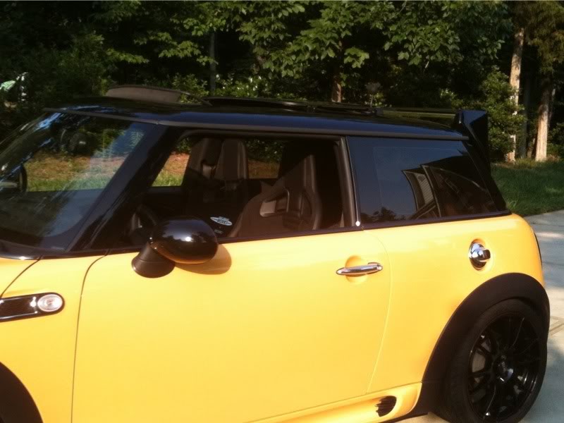

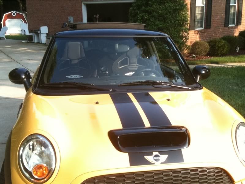

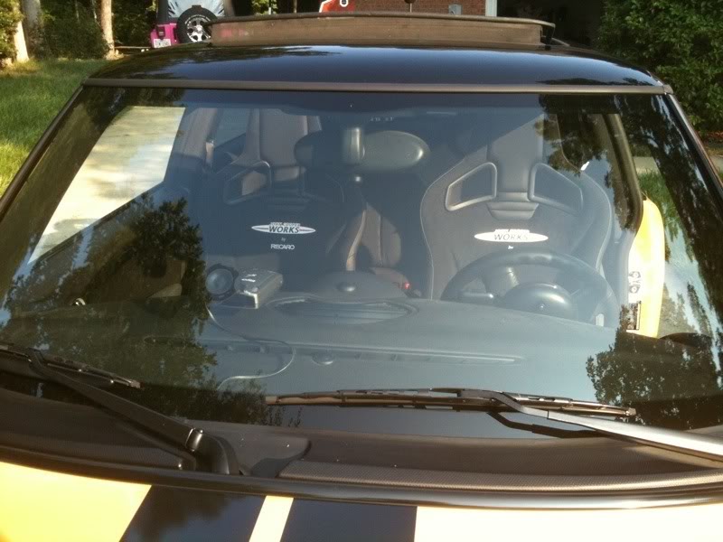

As requested...
Next week I have an upholstery guy coming to pic up the spare rear seats. He's going to cut foam to match the curvature of the front Recaro seats and then reupholster them in black leather and suede. Before he mounts everything, I'm going to an embroidery shop to see if they'll make the logo. (I'll probably have to do the same thing I did on a Corvette.. .that is, get written permission from the manufacturer)
Mark
