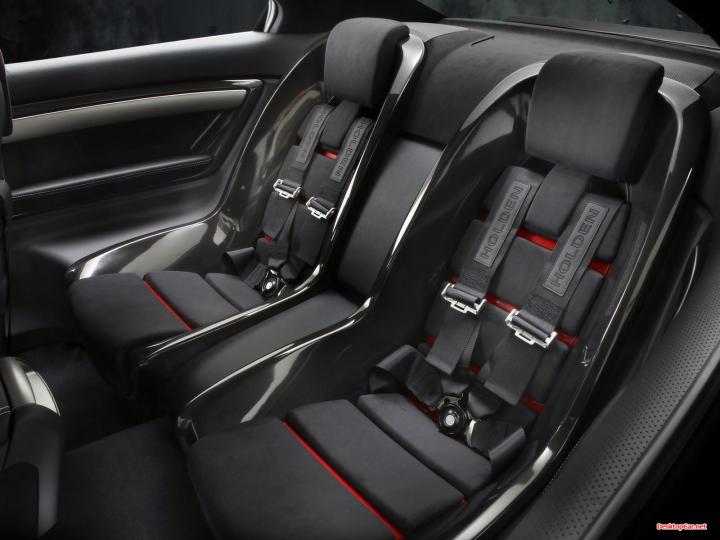

For a second there I thought you got these seats... I like the one ones you got a million times better!!!!!
The back seat idea is ok, but I've seen better.
How do your seats go tilting forward to let rear passengers in/out?
I had a (cough) Beetle for a few weeks when my mini was in getting fixed and the seats it them kinda lift up like an old person lazyboy. Makes it way easier to get in/out. Someone should make a kit to make the mini seats do this.
Here's an idea for ya...
Attached Thumbnails Guess I jumped the gun on the new seats...-holden_coupe60_126.jpg
