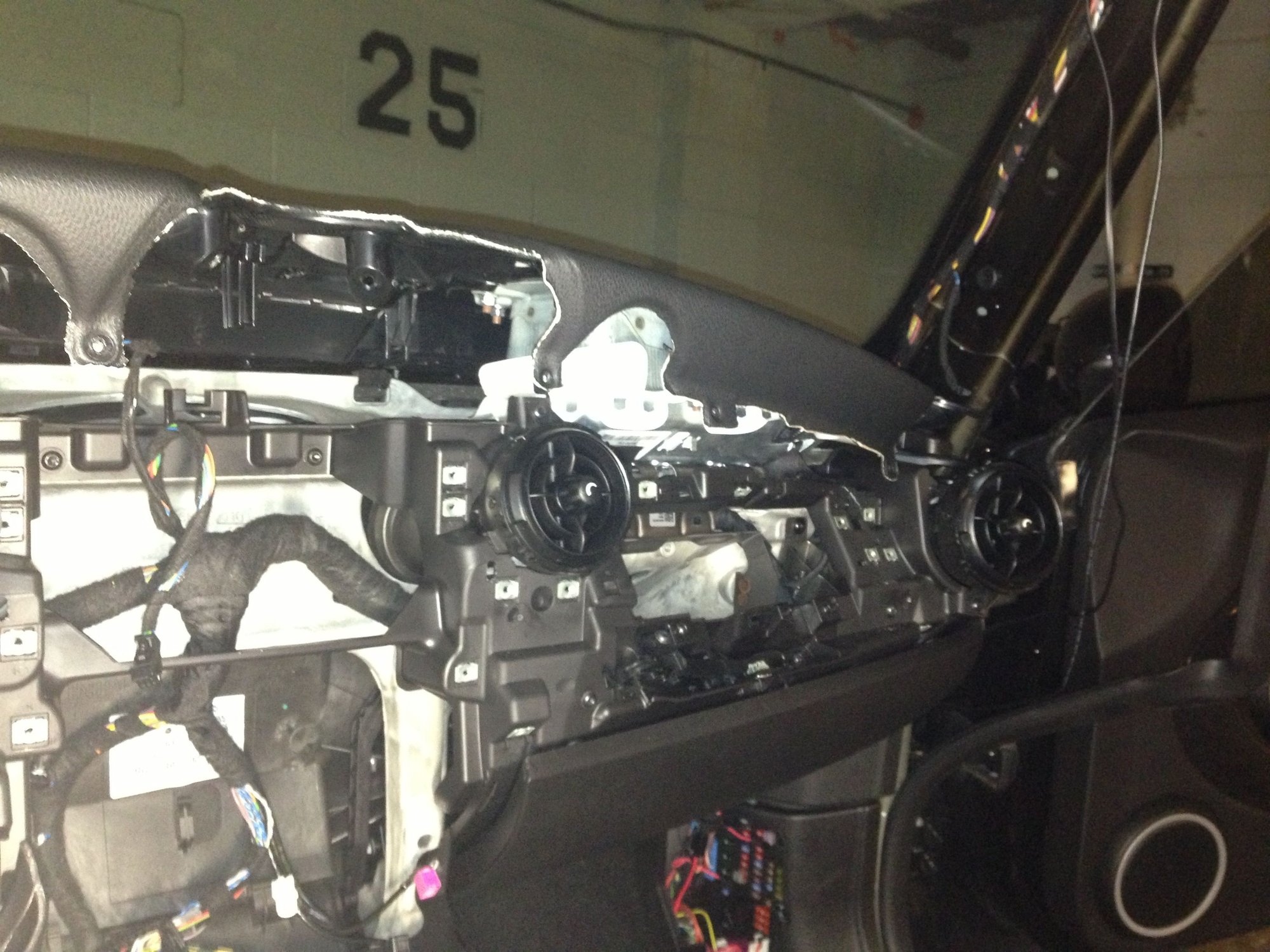

Just finished, I've successfully installed the factory alarm in my 2012 mini cooper s. So it is possible, but let me warn anyone looking at doing it. It is hard.
Pictures coming soon, but here is the quick summary:
  • Remove battery connectors
  • Remove wiper arms
  • Install tilt sensor/siren under wiper motor
  • Install hood switch
  • Run wiring harness to the through the firewall on the driver's side
  • Remove all interior panels
  • Remove Radio
  • Remove A pillars
  • Remove top of dash
  • Remove Remove Remove
  • Wire up CAS and steering wheel. (Note the CAS is under the top of the dash just above the steering wheel.)
  • Run rest of harness over to the fuse box on the passenger side. (Pick a very direct route as harness is barely long enough. I went under the glove box.)
  • Wire up all the connections in the fuse box
  • Run remaining wires up A-pillar on the (right) passenger side
  • Install sensor in head unit
  • Close up and put it all back together
  • Get coding with NSCExpert ($302 added to the FA)
Words of warning:
  • Wiring diagram uses German abbreviations for colors.
  • Harness is shorter than you would think.
  • A lot of the connectors are in what I can best describe as cases. These will prevent the insertion of pins. You must remove these cases first.
Took me two days to do, and about 20ish hrs.

Install guide in post #48 of this thread. The pictures I promised and never delivered are below (apparently the lighting, the camera, and the photographer all were terrible):
The right side cowl needs to be removed
Left side windshield cowl needs to be removed
Wiper motor is on the left side, the rubber grommet on the far right side of this photo is where I ended up running the wires through the firewall
Wiper motor with siren installed to the left of it. (apparently the lighting and my phone's camera were pretty terrible in 2013)
This is where the hood switch gets installed
Kombi wiring exposed, we need to attach a wire here to enable the red flashing light
Taking apart the dash
Success
