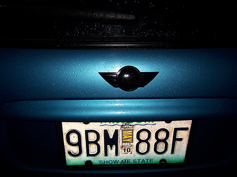

I used high heat engine enamel for mine after plast-i-dip failed. Primer, couple color coats, and like 5 matte clear coats. Its so resilient that I figured it'd have to work. So far I only got the gas cap, tow hooks, OEM emblems, and a previously chrome "R53" emblem done, but plan to do the rest. Winter's just been too cold for paint to set up properly. However, it has served as a torture test for the paint, and after 4 months of freezing weather, snow, ice, salt, and multiple car washes, it still looks perfect.
