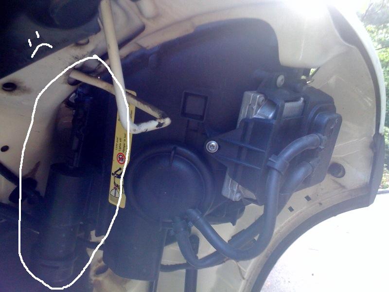

I'm feeling a little stupid and having a little trouble trying to get the headlights off.
I can't figure out how to get this part off, I don't even know what it is..

that gave me trouble the first time too, its the headlight washer.
-press the clips on the side of the shaft in, and remove the washer cover (the half moon shape thing in front.) through the front of the headlight.
-then I believe the rest of the assembly you can push out (towards the engine, when your hood is up)

Awsome, just got them off. Thanks.

Here's the trick: undo the 3 screws holding the Xenon ballast on, and it will swing away on its hinge. The complete headlight assembly can now be removed from the front (outside) of the bonnet. I removed these silly washer thingys ages ago, as I never washed my headlights (how did we get along without them for all those decades?). No washers, no hoses, nothing but clean headlights and bonnet liner.
