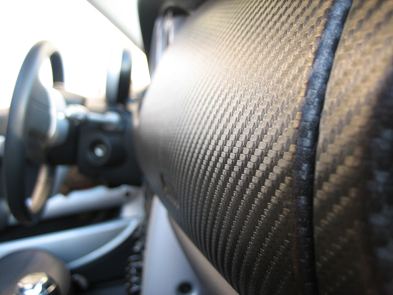

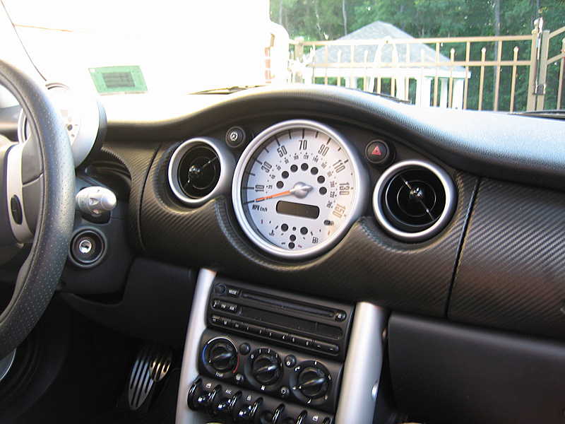

Did my dash in carbon fiber.
welp, did mine today.
the curves turned out to be quite the pain in the ****.
came out great though.
any shiny spots are just sweaty finger prints, it was about 95 degrees outside.
thoughts?

neffywrap.com, got 2sq yards.
got 3M spray glue (90 grade) and went at it.

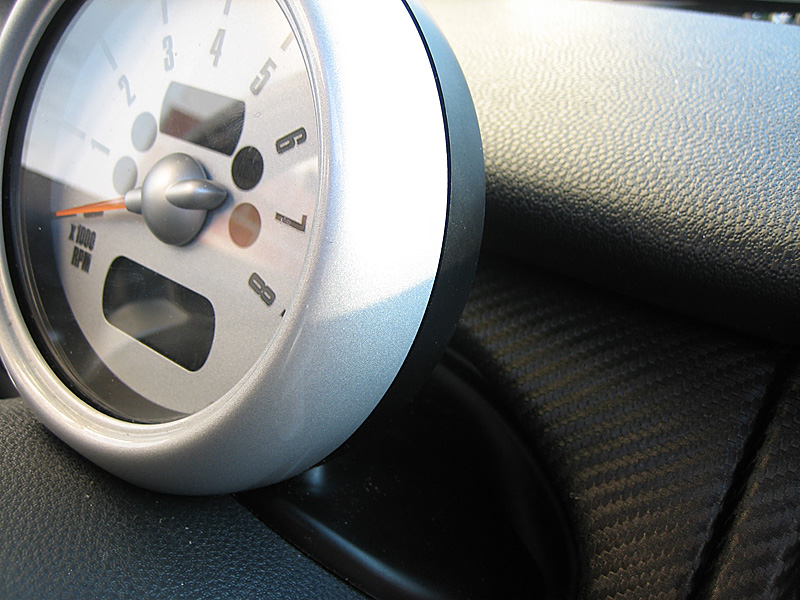

here's a detail of one of the tough spots.
i'm contemplating doing the horn area and silver ring on my 2 spoke steering wheel. i need to find instructions to disassemble it though.

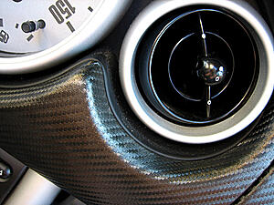

jbell, Im curious as to how you did the air vents.
Old Jul 7, 2009 | 07:34 PM
jbell's Avatar
jbell
Joined: Sep 2007
Posts: 207
trial and error, wasted one vent shaped piece about 8"x8". Basically you make a K shaped cut started at the upper corner where the vent is NOT the deepest. gotta make sure you don't cut where it wraps onto the deeper lip parts.
in the end, it took 16 fingers jammed in there (no tumbs) to just hold it stretched in place. not that big of a deal.
its the biggest stretch. its been 36 hours now, spent a good day in the 90 degree sun. jet black car... had to be 120 inside it.
seems to be holding great.
if it slips, i'll just line that area with another piece of fabric, and not do the stretch. a small piece of black suede would look nice inside the curve there.

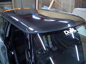

i got my roof done wif 3m carbon fibre film from japan
So the vents are a separate piece of fabric. I was curious cause I couldnt figure out another way of doing it, but I didnt see any seams.

no. right now its just one piece for each of the 5 pieces.
any more photos?

Yeh, that CF roof looks pretty fancy. That's a big job, with great potential to effup. Still, glory goes to those who risk it all!
OK I see. I guess since the 5 piece has the air vents on separate panels, it wouldnt be so bad to do it that way.
I have a custom 1 piece dash tho so I might just have to leave them black in there or use a separate piece of fabric.
it would be the same process, just don't cut the vent separate.
shouldn't be any harder to pull it off.
