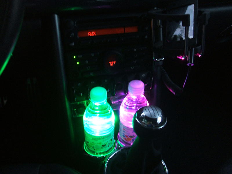

@MyMiniGadget:
Here are my cupholders in the daytime. My car was finished this morning, so I haven't gotten a chance to see them in the dark yet, but I will definitely be taking more pictures of all the mods later tonight The cupholder process was relatively easy, and as you can see I can still fit bottles in there even with the added switch holder, I just won't be able to fit very tall/wide to-go cups. I was very please with how the lighting looks even without the water bottles, kind of an unforseen added bonus with the way we angled the LEDs. Either way, I'm excited to have my baby in one whole piece again

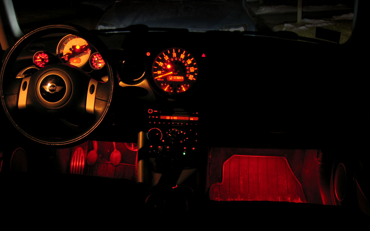

Here's mine. Pretty simple, two led strips that I put into plastic tubes and ziptied underneath using an add-a-circuit to power them:
DIY R50/R53 Mood Lighting!-awhuu.jpg

I like that. do the footwells match the dash more in person?
Old Apr 13, 2010 | 08:24 AM
  #81
plasticknives's Avatar
plasticknives
Joined: Jan 2010
Posts: 285
From: MA
Yea it's pretty much a perfect match.

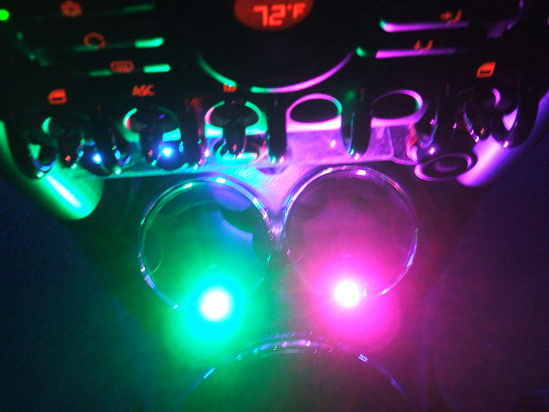

Night shots of the cupholders! Sorry I didn't get these up earlier, it completely slipped my mind the past few months. Anyways, the cupholders each have one superflux LED from Oznium.com drilled into the bottom edge nearest the shifter and angled slightly toward the dash. All in all, it was a super-easy mod that only takes a few minutes once you get that piece out. I have them wired to a switch so I can turn them off as needed because those suckers are ridiculously bright, as you can tell even in the daytime shots.
Attached Thumbnails DIY R50/R53 Mood Lighting!-dscf1862.jpg   DIY R50/R53 Mood Lighting!-dscf1866.jpg
