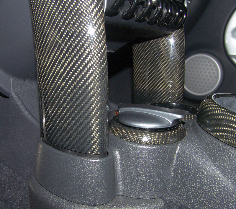

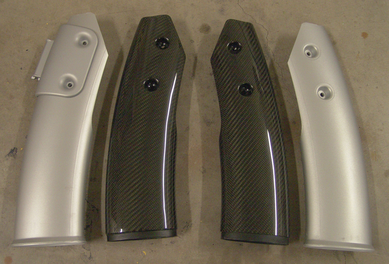

OK, mission accomplished! Thanks for all your help. I had to remove the plastic piece that holds the small tray forward of the center console in order to pull the console trim up. Turns out I probably didn't actually need to pull of the gear shifter ring or the mirror adjustment piece, but I did it anyway. The stock downtube was mushroomed at the bottom as stated before (see picture). The carbon fiber downtubes did not need to be installed from the bottom, but drop in like on the pre-facelift models (hmmm, maybe I got some old parts...). This of course made the installation of the new downtubes easy. Only problem is the CF downtubes don't quite fit perfectly at the bottom (see detail picture). Not going to worry about it though.

Looks great! - I have the same exact gap at the bottom of my carbon fiber downtubes, but in 2-1/2 years, no one else has ever noticed.
And you didn't get old parts - the JCW carbon fiber downtubes were never updated with the flared ends like the stock '06 downtubes have.

Made that way so you don't have to relieve the openings in the console like I had to with the leather. With the carbon fiber they are a slightly larger diameter too. Those CF tubes do look great!!
