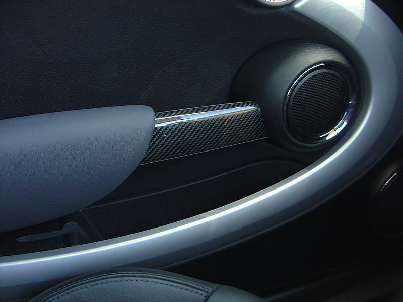

My new additions
The speaker grills wer a royal pain to get off. So i bought new ones just in case i damaged the originals. It's surprising that once you do this and you're not scared of damaging the originals, how you get them off damage free Pair for sale if anyones interested in chromline versions
They look great especially for less than £70 ( £100 if you include speaker grills )
The JCW wheel is only subtlely different from std. 3 spoke, but somehow feels really special

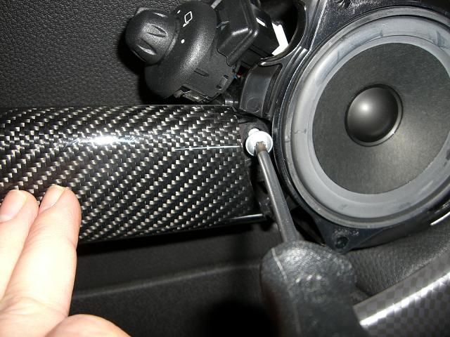

Hi, just got my jcw door grips, has anyone got fitting instructions for them? I have no idea where to start!

Hi,
First you remove the arm bolster. Easy to do by putting both hands palm down on the top and with your finger tips pulling up and out. This will give access to t20 star head screw. Other end is held on by another screw. To gain access to this one you have to remove the speaker grill. To do this you need a flat plastic trim removal tool which you slide into the gap between door handle and speaker. Once in a good way, you twist the tool to pop off the grill. On the drivers side you have to remove the electric mirror switch unit first. To do this i got a sharp ended o-ring pick ( like a metal cocktail stick with a handle ) and carefully pushed it under the switch shroud at the bottom and this popped it out without external damage to any trim.

Thanks for that japper, fitted them now and looks great!

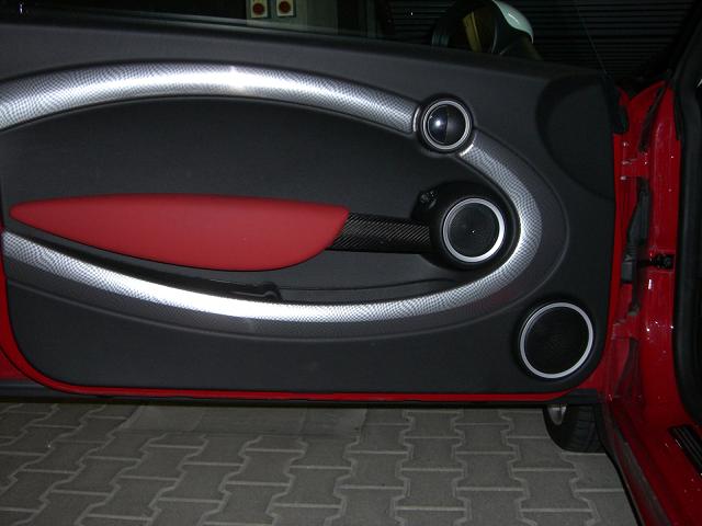

i have done it now
