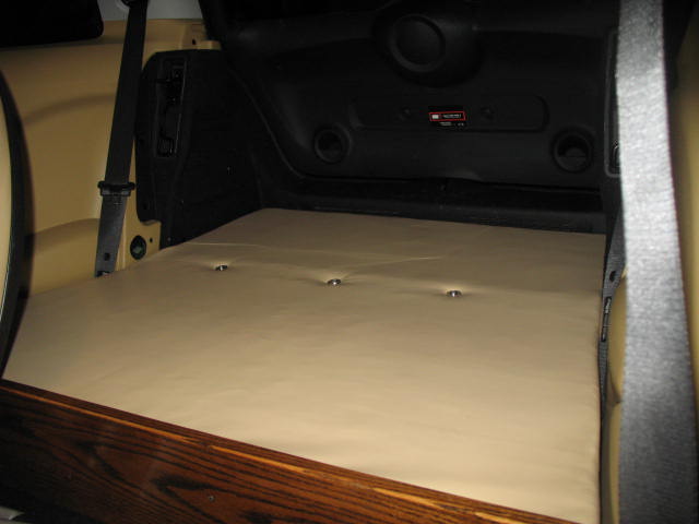

Here is my "Rear Seat Delete." I have Tuscan Beige Sprt Seats and two Long Nosed Lovelies (Greyhounds) who are the only rear passengers. The front facing trim board is oak to match the english Oak. The covering is commercial grade genuine Portugese Naugahyde. It is double hinged so that I have storage under both front and rear portions
