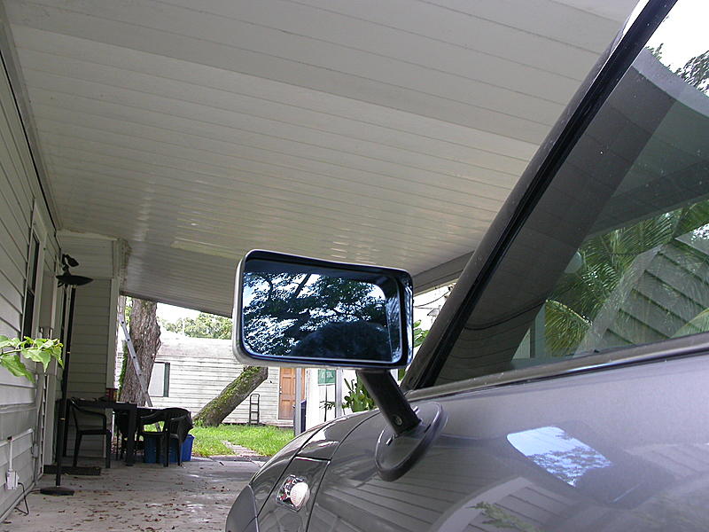

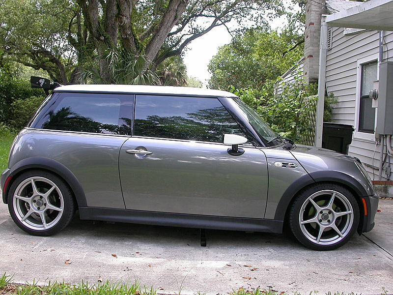

My next project after the RSD was going to deal with sun roof deletion but I got side tracked! I already had a piece of R8 on my car and it was time to add some R10 memorabilia to it. I always loved the look of these on the race car and it was going to be a piece of cake to put them on the mini. Quick and easy turned into 7 months of work and research and rework and new ideas and more research, rework etc. etc. I knew they had been wind tunnel tested, and run at Le Mans successfully twice, so I would get a couple extra mph and gain a few hp. from low drag, but BLING was the driving force. Plus Sid and Nat with their racing thingies had to be upped.
Still as usual there was the Carbonized “must”: lighter than OEM, use OEM mounting points, and be somewhat stealthy.
The following pics are from the 1st prototypes, mostly fiberglass (except stem and base). The base will not show the screw holes as it is redesigned and retooled at this time. Still lots of work before final full carbon version! I started on this on Nov. 25 07 and with racing season in full swing, it look like i'm looking to 11 25 08 before I’m done with it. This thing has gone wild!!!!!
Attached Thumbnails Carbonized gone wild!-dscn4219.jpg   Carbonized gone wild!-dscn4220.jpg   Carbonized gone wild!-dscn4223.jpg

If the key word in your post is "could" then the answer is Yes! As I had to build them from scratch, I now have high temp carbon fiber molds for most of the composites parts. The question is how to build them at a reasonable price? It is not the carbon versus glass( as it is a rather small part, area wise) as much as the process (vacuum/heat), and all the other components, 1 set of mini mirror frames, for wire harness, gasket, etc. 1 set of Audi mirror glass, 1 set of pre-04 Audi/BMW/ merc./saab/etc actuator and a few custom CNC'ed parts like the cam locks, witch would all make it prohibitively expensive to this crowd. That being said, I' m not giving up on the idea of producing them. I just have to work around this issues and find someone to produce the carbon parts. Here is a pic of all the parts involved in a "simple" rear view mirror. Keep in mind that both the housing and base are made of 2 or more assembled parts. Did I mention this thing going wild on me?

Love your rims

Plain Kosei's K1, affordable, light, strong (don't ask how I know) and easy to clean Love them!!

This is a dry run of all the fibers and vacuum material stack. Lots of stuff not much space. That's where Bart got his finger in action when all that was wet with epoxy.
This is a pic of the whole thing under vacuum, after is son manned the vacuum valve and helped chase leaks
The entire mirror, body and stem, is laminated in one shot. The shaft that Bart is talking about is a 2 layers pre-cured carbon mandrel that allows me to keep the foil shape until vacuum.
Thanks PARTSMAN for the pic posting guide
