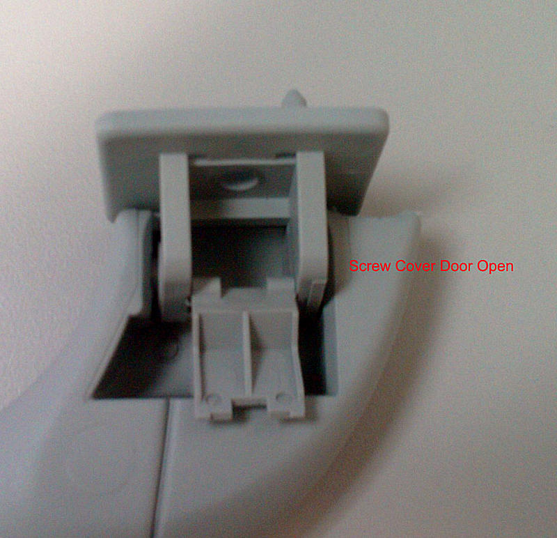

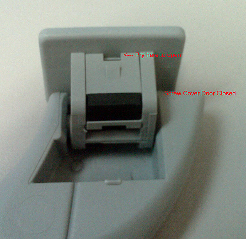

To remove the handle just hold the handle down with your free hand and using the flat head on screw driver from the tool kit flip down the little doors that hide the screw. Next flip the screw driver over to the Philips head and unscrew. Unscrew the one on the left first as that one has the spring that returns the handle to the up position. Next take the new sun visor and using the holes on the ceiling align the screw holes. IF the holes do not line up, then you have the visor upside down. Just switch the sides and it will line up perfectly. Now use the same screws that you removed and secure the new visor.
