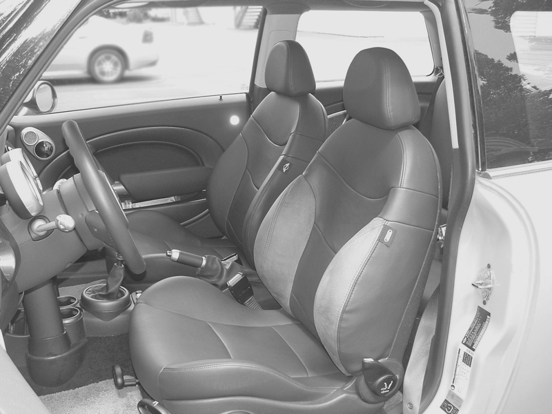

So I got my car back today, after going in for a "fitting" yesterday. Results are excellent!
In the pictures attached, I found it impossible to get a shot that showed the new suede panels and the OEM leatherette anywhere near their perceived colors to the eye, so I converted the pix to B&W.
The color tone match between the panther vinyl and the synthetic suede is very good, with the suede looking different mainly because of the grain, not the color. Depending on how it's brushed, it is usually a little lighter than the vinyl, and looks good with my grey Lloyds' carpets. From 10 ft. looking through closed windows, it is nearly unnoticeable.
As you can see, I had the bolsters extended about an inch forward, and about an inch thicker at the front of the bolster. At the moment, it feels just a hair snug to me, but there is 1/4" of material under the vinyl that will crush to fit.
By doing just the seat-back bolsters, entry and exit remains easy, and all the features of the seat were retained - adjustments, heater pad, etc. I put 1/4" of spacers under the front of the rail, to get more dish to the seat bottom, and the result is a street version of a racing seat - comfortable, but very supportive in the hairpins.
This work cost me $500 at Bright Auto Upholstery in Portland, Oregon, and I'd recommend them. I decided to let them do the work after seeing some of their beautiful restorations in progress.

Not really an issue. The stitching around the side panels is nice strong stuff, designed to cut on the dotted line (perforated by the stitching) when the airbag deploys. The thread slices through the vinyl, and the airbag comes out.
All of the foam built-up on the bolsters is on the inside surface, toward me, and not around the airbag at all.
can you please show close-up pics of this? i'm having a hard time visualizing it
thanks!
thanks!
If you look at the pix of the drivers side, the bolster, originally one concave panel that goes from the center piece of the backrest to the outside edge, is now bulging forward. The added foam is shaped like the bolster, and then covered with a wider-than-original piece of fabric (actually two pieces).
Compare the driver and passenger seats in the B&W picture - it should be apparent. The bulging bolsters can be seen in the image looking down.
Color pix of both seats: https://www.northamericanmotoring.co...d.php?t=142990
