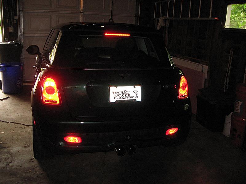

I installed both kits (the GoMiniGo brake-flasher and the rear fogs-to-brakes) the first month i had mine; here's a pic from inside my reasonably-dim garage. The MiniSpeed kit is a good value ($75 if you don't have rear fogs) if you consider that the list price at a dealer for just the rear lamp-assemblies is almost that much ... took me forty minutes to install.
