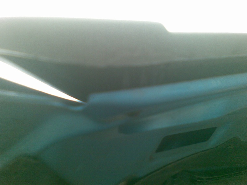

Originally Posted by TheFutureMrs.agokart
The top piece will install correctly and stay in place. Its designed to work with the hood you have.
Hmm. The center of it stays really tight in place, but the last two pieces that go into the hole want to come out, and do about half the way of the "screw" that goes in there...
Hrmm... That's odd. Is everything lined up correctly?

Yep. I'd give you some pictures, but my flash card reader is missing.
edit: added photos
As you can see on the last photo, the little black nipple thing is going thru; it just comes right back up. In the middle photo, if I were to push the grill down, it would slide in perfectly, but not stay in.
I feel like this product was made by a third-party Korean company...

my top grille gave me some trouble but i worked it around until it pushed into place...as for the nuts if you can it might be easier to get some more from the mini dealer
Injected molded plastic from China actually (no joke).
You may need to fasteners.
I'm closer than Ohio and would be happy to help but you'd have to come to me. I am actually helping a fellow club member with one in the next couple weeks.
It may be worth ordering new fasteners. Those little plastic "screws" are utter crap. You have to use a lot of pressure to thread them of the plastic post so they will stay. As for the lower grill, I ended up doing mine twice. The first time I used a dremel and was not happy with the results at all. The second time I used an exacto (sp)/ hobby knife to cut a groove in the lower grill and then snapped it off for a clean cut with a pair of pliers. I opted to pull the bumper the second time too, it's actually very easy. I then notched the bumper cover to match the tabs that I left on the lower grill and used screws to set the lower grill in flush. I also opted to use 3M detail tape (same as the belt line blackout tape) behind the lower grill versus using paint. I figured the paint would fade and chip with grit over time whereas the tape would hold up better (or so I hope).

we have done quite a few of these ..
If your not careful the "nuts" dont hold that great ...you need to be careful when installing.
A trip to the hardware store should come up with some fastners that may hold tighter and allow you to "pull in" the sides ...
The lower needs to be trimmed ... maybe find a local club member that has don this and ... well ... buy him a beer.
I could dremil the lower for you ... but you would still need a bit of mod on the bumper.
It needs to come off for best results
