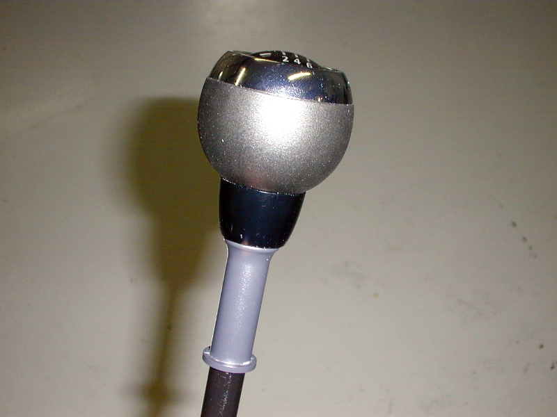

This extension works; it effecttively raises the anti-rotation slot by about 3/8" or so, to engage the key that's inside the ****.
I've made a couple of them from aluminum; it's a simple machining job.

That's true; the bottom section of the snap area has to be cut off.
Here's an R56 **** on an R53 lever.
One thing I noticed is that the snaps on this particular **** don't lock as tightly onto this particular shift lever as they probably should; the **** is easy to pull off.
I don't know how much of that is due to the fact that this shift lever has had hundreds of ***** attached to it, though.
