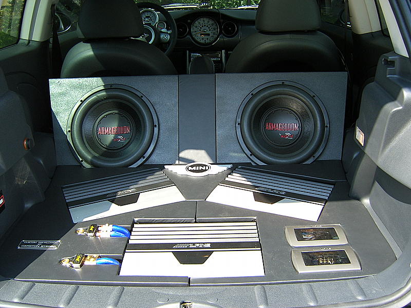

The problem that I was trying to get around was that I no longer have my back seats, and in their place, is a stereo setup. (I attached a pic)(pic is old, I now have a rear strut brace in)
I was trying to figure out a way around a roll cage/bar only because I wouldn't be able to install it without ditching the stereo setup. Well, maybe I'll give some racing seats a try. I just love being held completely in place while driving. For now, my CG lock will have to do.

Nice set up. So is it impossible to get the Autopower in there?
Also, you could think about having an "adapter" made to lower the bar in the first option you posed...This may work well if done correctly, safety is a must.

I'll have to see about some different options. I don't think I'd get that autopower cage in there, because the bars would end up being exactly where my sub boxes are.
Maybe an adaptor plate could work, and I'd also have some slots welded onto that harness bar for the harness to slide through.
