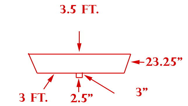

Here ya go. Sorry it took a while, and for the drawings looking like ***, but I hope you get the jist.
Here is the aerial view.
Here is the side view.
The front lip is 1.75" tall. and the back angle in the above picture is the tab that sticks out in the first picture (3" x 2.5"). This is where the bolt goes through that held your seat bracket to the frame.
Hope this helps. My RSD kit is also carpeted, so that might change the measurements a little, too.
