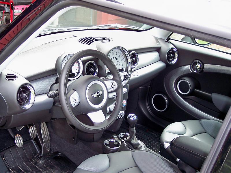

OK, I just recently installed a portion of my "retrofit" chromeline interior.
The parts include
1) CenterCluster
2) RH & LH A/C Vents
3) RH & LH door release bezels
4) 3 Cup holder bezels
5) RH & LH Door speaker (Bass) bezels
6) RH & LH Door speaker (Mid-range) Bezels
Standard Radio
So far I have been unlucky in getting the Tach surround bezel but, my parts guy is working on it. ( Otherwise it comes with a new Tach= $537.00 Ouch!!)
The parts above, minus the Tach problem was approx. $275.00
Unixgal was a great help on the install. See the link below.
https://www.northamericanmotoring.co...d.php?t=110837
The directions are the same with or without Nav.
To change the right and left A/C vents are as follows.
1) Pull down the window weather strip. It's just glued in place ("A" pillar)
2) With a small screwdriver, pull out the "airbag" cover, pry lightly from the
side closest to the rear of the car. Then pull the pillar covers from the
top towards you,,lightly. there are 2 clips in the cover.
3) Then pull off the side covers on the vents (R & L Side) they also snap in
place.
4) The vent assy. has 4 screws total 2 on the side facing the doors, 1 on top
underneath the "A" pillar, and 1 on the dash facing you.
5) The Dash cover behind the tach "Pulls" off from the bottom. Tug firmly and
it will release. There are 3 clips behind this piece.
6) The right side A/C Vent has a small plastic cover (underneath the storage
compartment door, if you have the storage compartment) which just pulls
off and the screw is behind it.
Re-install in reverse and your back in business.
Cup holder rings just snap in and out
The door release bezels have a "pin" on the bottom, just pull the pin down and gently pull the bezel towards you.
I couldn't stand the "Fisher/Price Toy" look
Hope this helps those who want to change to Chrome.
Carl
